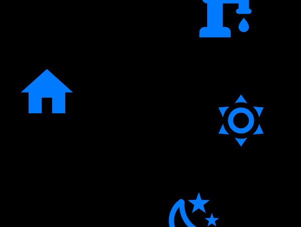

Let me play with the radial menu approach. I don’t have any that use pictures (but I know its possible) and I want to see how it lays out (hopefully not tiny pics).
I would definitely need help with a way for it to auto-rename the pics so the 11th one gets purged and then the displayed picture is always in reverse chron. What you said sounds good, I just don’t know how to execute that on my own.
I’ll report back on the radial menu
EDITRadial menu will not work for this. You can enlarge icons but not pics:
