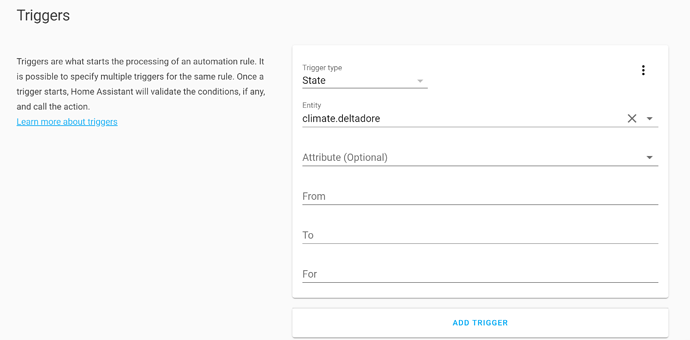

I´m working with an automation, and I need to know how can I configure this trigger to know when the pump is working (heating) ( usually green in the graph ) .
May you can help me
Thanks in advance
