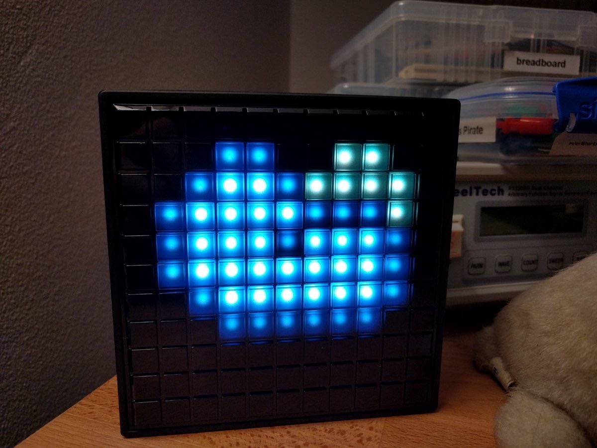

I’ve been working on a custom component to let Home Assistant interact with a TimeBox pixel speaker from Divoom.
So far, the component is able to switch between the built-in display modes (clock, temperature), and upload and display static images. I’m planning on adding support for animations eventually, as well as tools to make converting and loading images a little less hairy.
The repository at https://bitbucket.org/pjhardy/homeassistant-timebox has the component, a handful of images to get started, and docs about using it and creating images.

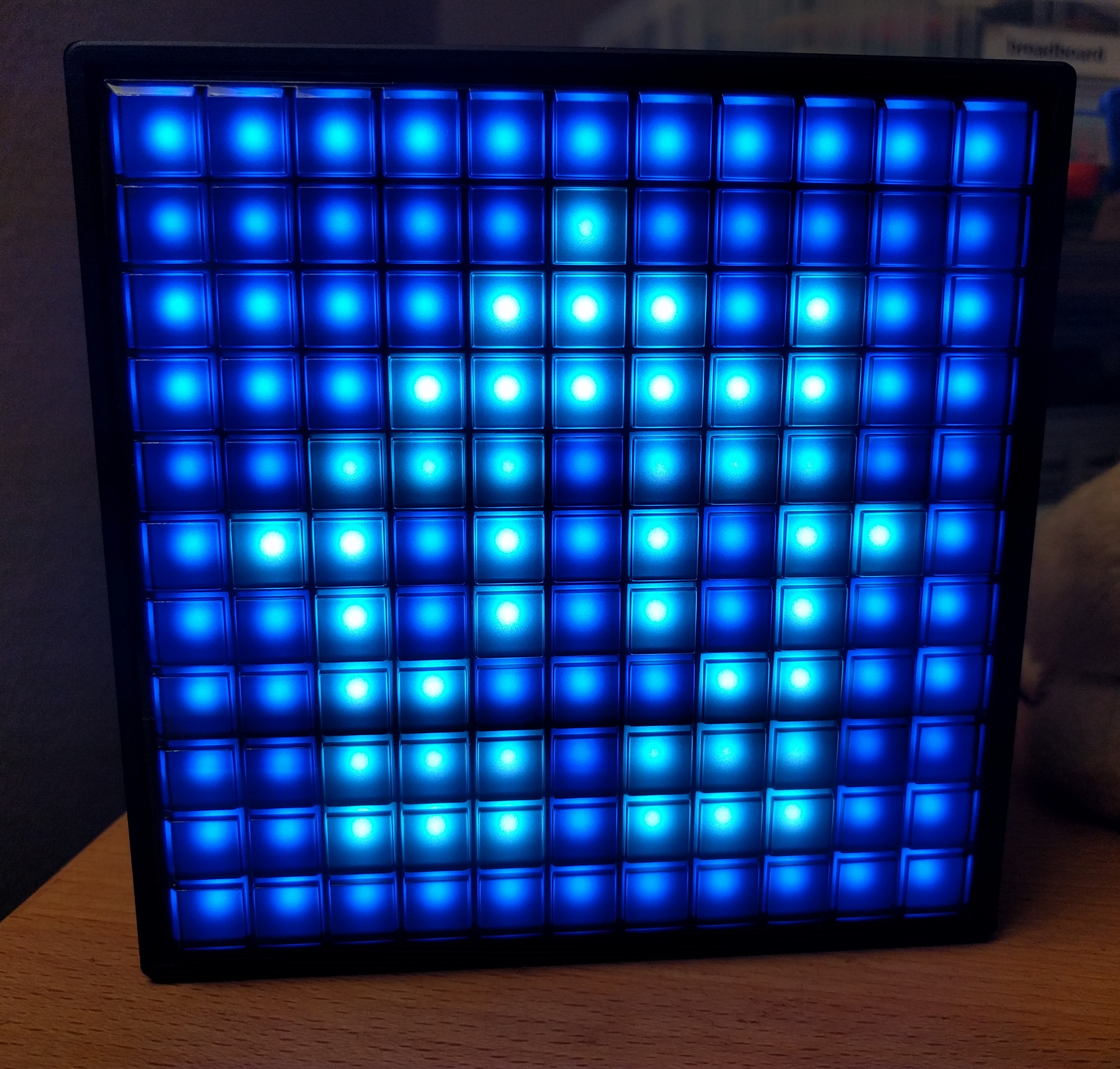

I got it working now with hassbian and timebox-mini. Here is a small guide:
with hassbian already installed:
  1. download the data from the bitbucket link in the first post of the thread
  2. extract the timebox-images folders to your config folder
  3. create a custom_components folder in you config folder and extract the notify folder in there
  4. turn on the timebox device
  5. type sudo hciconfig hci0 up
  6. type hcitool scan and write down the mac of the timebox somewhere
  7. add the component to the configuration.yaml so that it should look like this:
notify:
  - name: ledbox
    platform: timebox
    mac: your mac address
    image_dir: timebox-images
  1. create a test automation. Here is an example:
- id: id8
  alias: 'Test'
    platform: state
    entity_id: input_boolean.tester
    from: 'off'
    to: 'on'
    service: notify.ledbox
    data_template:
      message: blank
        mode: image-file
        file-name: 'sunny'
  1. restart HA and test your automation
ATTENTION: I had some error messages that an image named ha-logo.json was missing and it was indeed not located in the images folder. I simply copied one of the existing images and adjusted it with all 15 so that you basically get a white image. Then simply rename it with ha-logo.json and that will image will be loaded after connecting eg. after a homeassisstant restart.
