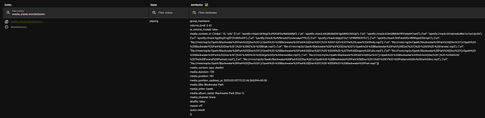

Could you please attach some screenshots of the Developer tools > States section for the media players and lyrics sensors in question? That will help me see the state attributes and their values for debugging.

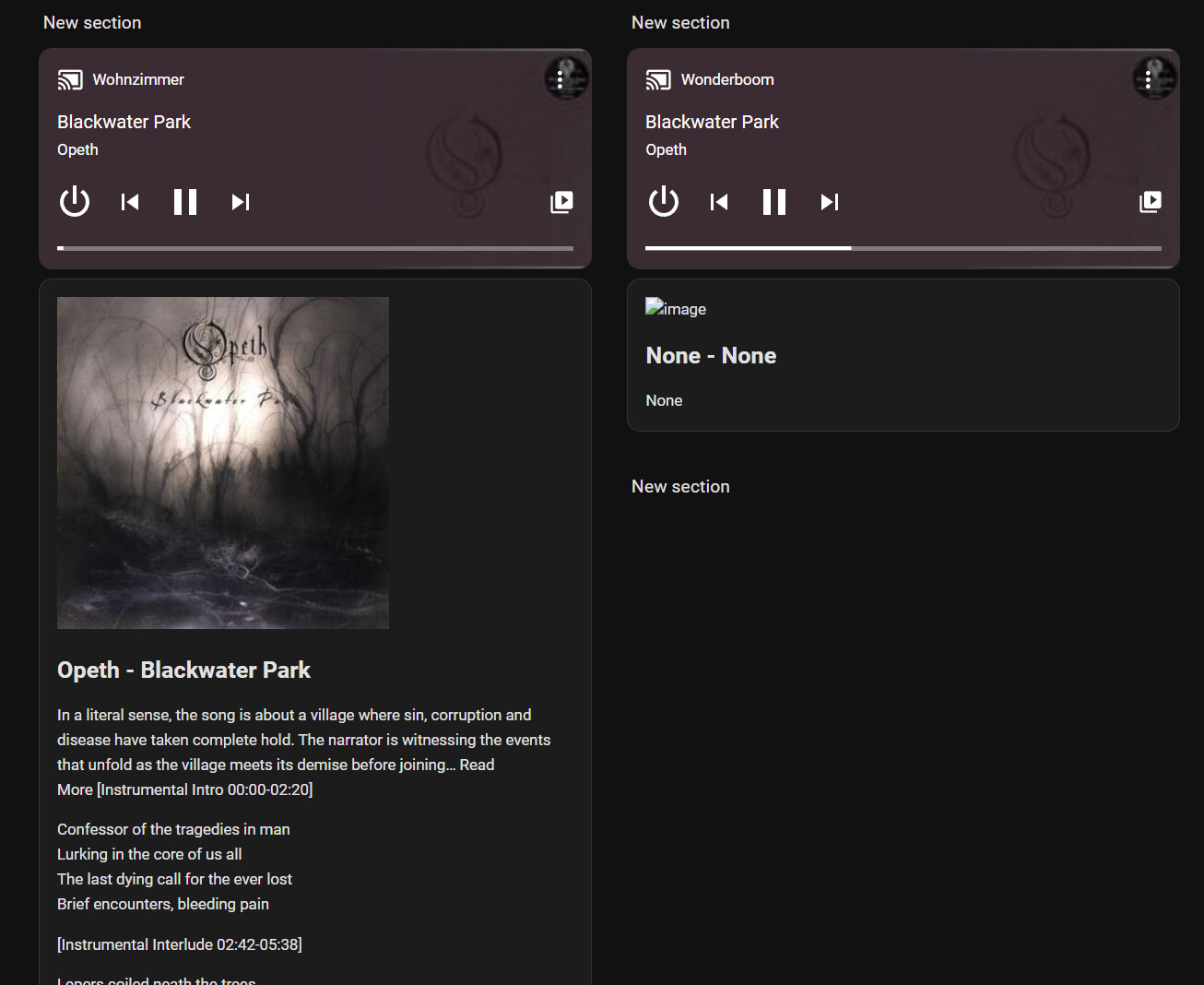

Here you can see the state of one player (Lyrion) that is NOT recognized while others are:
The genius lyrics sensor for that one:
grafik
And here, the two of them next to each other:
@Merc big thanks for the screen grabs. I was actually wondering if playlist content type would be a problem as I recently signed up for Spotify (been on YT Music this whole time) and noticed this.
Fix coming soon (playlist media_content_type is ignored · Issue #48 · robert-alfaro/genius-lyrics · GitHub)
