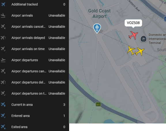

Hi everyone, I’m excited to try to get this working but I’m not having a lot of luck with the airport I am trying to monitor - It might be me!
The airport is ā€˜OOL - Gold Coast Airport, Australia’
Only 4 sensors are available and they are working ok.
Is it a local config issue that I am not seeing the arrivals and departures information in HA? (Which is showing ok on Flightradar24).
Thanks.

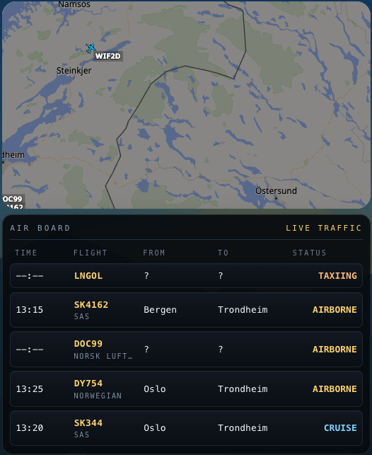

I didn’t really like the simple markdown output for the flight information, it felt a bit messy and hard to read.
So instead I used a conditional card together with tailwindcss-template-card to render a small airport-style board. The conditional card hides the board when there are no flights, and the template card makes it possible to build a cleaner layout with columns (time, flight, from, to, status).
This way the card stays compact and looks a bit more like a real arrival/departure display.

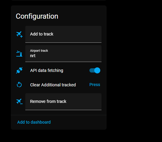

yea. I, too, see those exact unavailable. I installed FT awhile back and not really looked at all the sensors.
ok. figured it out. In the FT24 integration page where you see configuration, you need to input the airport code (IATA or ICAO) of the airport you want to track like so below. If you have trouble finding this tab, you can search for sensor text.flightradar24_airport_track and input the airport code.

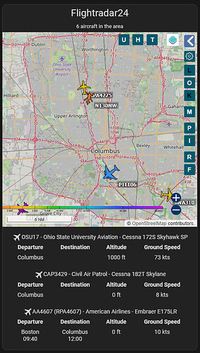

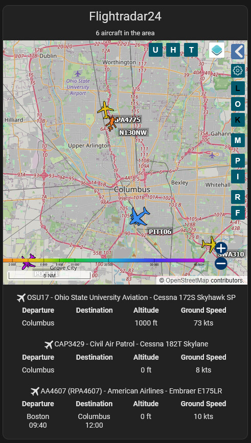

This is my ā€œFlightradarā€ card. It uses a custom:stack-in-card with a little bit of card_mod. The Markdown card uses table HTML instead of table Markdown. Setting its max-height in card_mod allows the overflow to scroll. I also set it to not show US flags, but it will show flags from other countries along with the name.
YAML Code

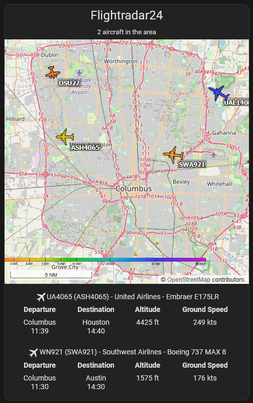

EDIT: Updated URL to include some extra options such as kiosk mode and settings brightness and contrast.
old image
