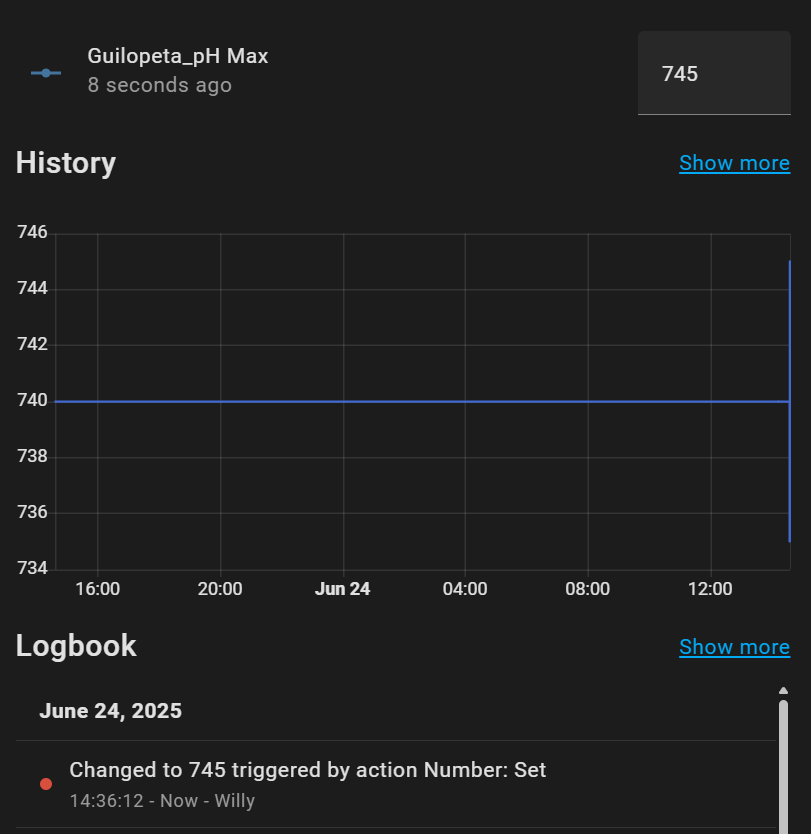

I can no longer update those values, does it work on your end with current release ?
{‘gateway’: ‘NODE_AWSxxxxx’, ‘poolId’: ‘05xxxxxxxxxx’, ‘operation’: ‘WRP’, ‘operationId’: None, ‘changes’: ‘{“modules”: {“ph”: {“current”: “785”, “tank”: 0, “al3”: 0, “pump_low_on”: 0, “status”: {“high_value”: 768, “low_value”: “650”}, “pump_high_on”: 0, “type”: “ACID”}}}’, ‘pool’: None, ‘source’: ‘web’}
No, it doesn´t.
You only can put 730, 735, 740, 745…so the step should be 0,05 points.
Regards
found it, I was loosing the pool because of the atmospheric situation and my network RSSI below expectation. Pool is distant and wifi is sometimes not at best.

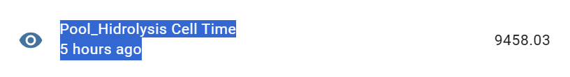

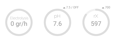

By the way, cell time is something I do not understand at all.
the “off” here in the middle of the official web user interface is related to the PH Pump, so it’s used and should be updated accordingly.
Cell Time, still a mistery :slight_smile:

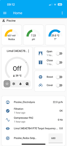

Future release will include a fix for Hydrolysis to be correctly reported in gram by hour and renamed to Electrolysis
Testing now…
I had a draft message just to ask for those 2 things !!!
Great!
Thanks @fdebrus

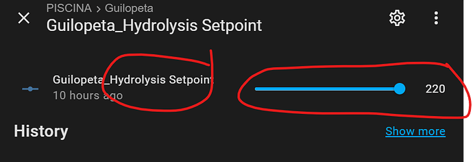

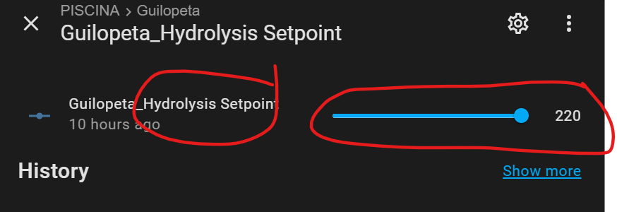

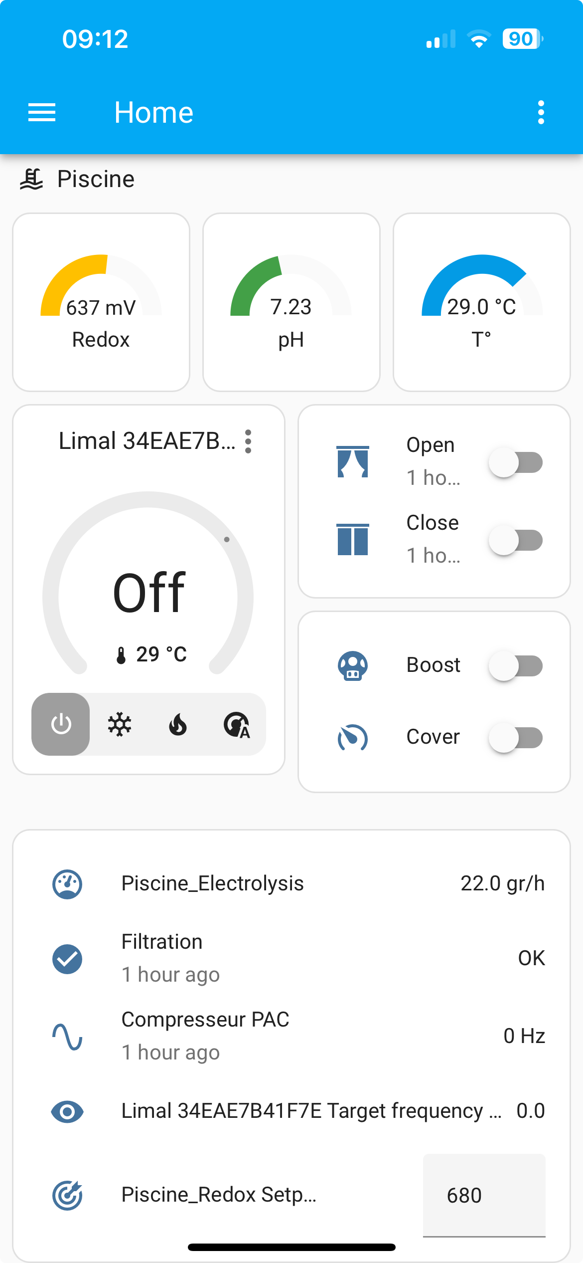

One last change I would propose would be to change the scale of the Electrolysis Setpoint to 0-22 instead of hundreds, wouldnt it?
This value is dynamic, my guess is that it is based on your model and the amount that can be produced by the cell.
int(dataservice.get_value(“hidro.maxAllowedValue”))/10
now, we are obviously not on the latest release, it shall report 22 not 220 :slight_smile:

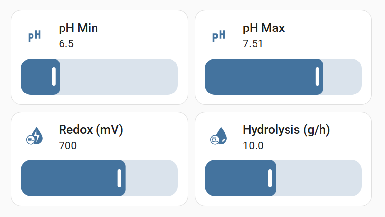

Just running last version, it works perfectly!!!
I think we shall get rid of, it is useless
Useless at all.

Hi guys. v0.3.8 is great. Works perfect with the newest model (2025) of Aquarite Flo Advanced.
Thank you for your great work!
