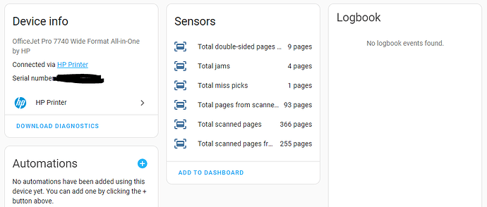

Hi all,
Over the last 2 weeks I started working on v2,
It was challnging, especially when HA is not nativly supporting the level of SSL security HP Printer demands,
below is description of what’s new, screenshots and plans.
Description
  • v2 is leveraging the HP Printer EWS (Embedded Web Server) to the maximum,
    It extracts all endpoints from the printer, not just to get details but also allows to perform actions.
  • Integration is working with nontraditional connection pool of HTTP of HA to allow working with more strict SSL protocol that new version of HP Printer demand (for those of you who are struggling with SSL errors while integrating).
  • Managing entities became easier - it will be much easier to suggest and add new entities, all by JSON configuration file.
  • Diagnostic component allows to extract all HP Printer data on top of what is being generated within HA components, that’s the place where you will find the additional entities you will suggest to add.
  • Device structure is built according to get the maximum also from HA, Main unit holds – Printer, Scanner, Copy, Fax.
    Consumables are sub devices of the Printer.
  • Currently added entities are for read only, thought it would be better to just provide the entities that were already supported and add them later.

Integration page
integration
Devices of integration
Devices associated with integration
Main device
main device
Copy
copy
Fax
fax
Printer
Ink
ink
Scanner
