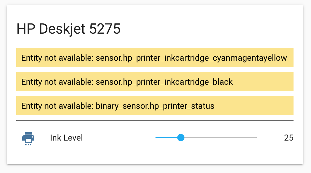

I followed your code but cannot get in the frontend this part:
     - type: entities
         - entity: sensor.hp_photosmart_5510_b111a_ink_black

I don’t get the attributes showing in the card… Where is the error?
Obviously I changed the sensor names reflecting mine…
What i get is this:
Schermata 2020-02-18 alle 12.36.29
Anybody can help me please…

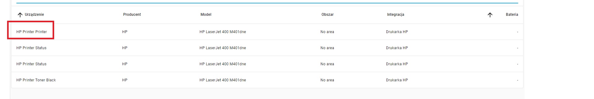

I found one bug for me . It show in integration HP Printer Printer and as entity also show HP Printer Printer but it is entity which show value printed pages and shoud name HP Printer Pages.
Look
2
The first HP Printer is the name of the integration you have set, the name of the sensor is “{Integration name} Printer” which is the printer outcome sensor, for AIO models there is also one for Scanner.
By the way, the unit of measurement is pages.
