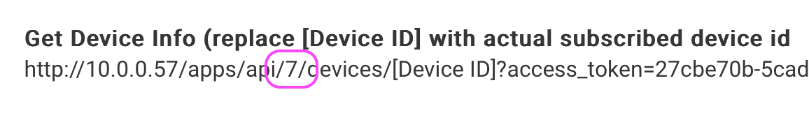

I’ve just bought a Hubitat Elevation C8 in order to add Zigbee and Z-Wave to my Home Assistant setup. The hub is working fine and I can control a Zigbee Smart Socket as expected. However, when I try to add the integration to Home Assistant all I get is “Unexpected error”. I tried turning on debug logging in configuration.yaml but the only log entries I see are:
2024-12-02 13:10:16.452 DEBUG (MainThread) [custom_components.hubitat.hubitatmaker.hub] Setting host to 192.168.0.10
2024-12-02 13:10:16.453 INFO (MainThread) [custom_components.hubitat.hubitatmaker.hub] Created hub <Hub host=192.168.0.10 app_id=Home Assistant>
2024-12-02 13:10:16.482 ERROR (MainThread) [custom_components.hubitat.config_flow] Unexpected exception
I’m obviously missing something pretty basic here. In the integration configuration page, the only fields I filled in were the host IP, the name of the Maker API (Home Assistant) and the access token. Do I need to fill in any of the optional fields?
When I try to access the Get Device Info URL on the Maker page, eg http://192.168.0.10/apps/api/3/devices/3?access_token=eee733e7-d433-4e8f-a56e-d4970f6c4728 then it returns the expected result.
Could there be some config that I need to change on the hub?
Any help or pointers would be much appreciated.
I don’t think you’re missing anything, although that error makes it hard to tell. I just pushed out v0.9.39 that updates the config flow code and shows more error context, so that may make it easier to see what’s happening.
@jason0x43, thanks for the quick response. It’s sorted now! :slight_smile: As I feared, it was user error :roll_eyes: I was entering the Maker API label, ie ‘Home Assistant’ in the config page but having re-read your setup instructions I noticed that they mention “the 2, 3 or 4 digit number after /apps/api/ in any of the Maker API URLs”. I couldn’t find that magic number anywhere, but having exported the json config I found it!
Thanks again for your efforts and assistance :+1:
Oops, I should have noticed the part of your screenshot that said app_id=Home Assistant. :slight_smile:
Glad to hear you got it working! For future reference, you can see the app ID in any of the test URLs on the Maker API page in Hubitat, or in the page URL when you open the Maker API in Hubitat.

Log on Hubiitat (removed token info to ********):
[app:3](http://192.168.1.104/logs?tab=past&appId=3#)2024-12-28 08:22:14.556 PM
debug
Testing URL is http://192.168.1.104/apps/api/3/devices?access_token=ddac7081-30c1-479a-ab87-*************
[app:3](http://192.168.1.104/logs?tab=past&appId=3#)2024-12-28 08:22:14.555 PM
debug
Initialize called
Thank you in advance.
Just to add to this, I installed the Firefox add on in HA, and I can reach the Testing URL from the Hubitat log from the browser in HA. So apparently they can reach each other on the network. The Hubitat logs shows the calls from that browser test.
Thanks
Hi everyone. I was able to solve my problem. The issue was putting “https://” in front of my Hubitat (C-8 Pro) IP address when configuring the HA integration. I hope this will help future integrators to not miss this simple distinction.
