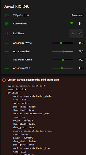

Love-lace card:
square: false
columns: 1
type: grid
  - type: entities
      - entity: sensor.helialux_profile
      - entity: switch.aquariumledmanual
        icon: mdi:fishbowl-outline
        name: Aquarium Handmatig
      - entity: input_datetime.aquarium_led_timer
      - entity: input_number.aquarium_slider_wit
      - entity: input_number.aquarium_slider_rood
      - entity: input_number.aquarium_slider_groen
      - entity: input_number.aquarium_slider_blauw
  - type: custom:mini-graph-card
      - entity: sensor.helialux_wit
        color: white
        show_state: false
        show_graph: true
      - entity: sensor.helialux_rood
        color: '#ff3333'
        show_state: false
        show_graph: true
      - entity: sensor.helialux_groen
        color: '#99ff99'
        show_state: false
        show_graph: true
      - entity: sensor.helialux_blauw
        color: '#0099ff'
        show_state: false
        show_graph: true
    hours_to_show: 12
    points_per_hour: 4
    show:
      legend: false
      icon: false
      labels: false
      state: false
    hour24: true
    height: 200
    state_map:
      - value: ' 90'
        label: Clear
      - value: 'on'
        label: Detected

I saw that some people weren’t able to use this. I think this is because of one small error. In the command_off it has to be action=14&cswi=false instead of action=14cswi=false.
Also you are using a custom card which can be downloaded with HACS: mini-graph-card
