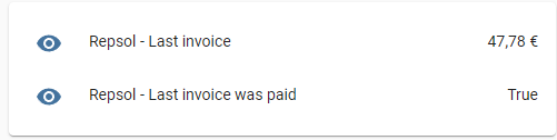

Just released version 1.1
Added 2 new sensors: Last Invoice Amount (Numeric) and Last Invoice Status (Boolean).
  • Last Invoice Amount (LIA): represents the amount of the last amount.
  • Last Invoice Status (LIS): it’s a boolean that returns if invoice was paid or not.
