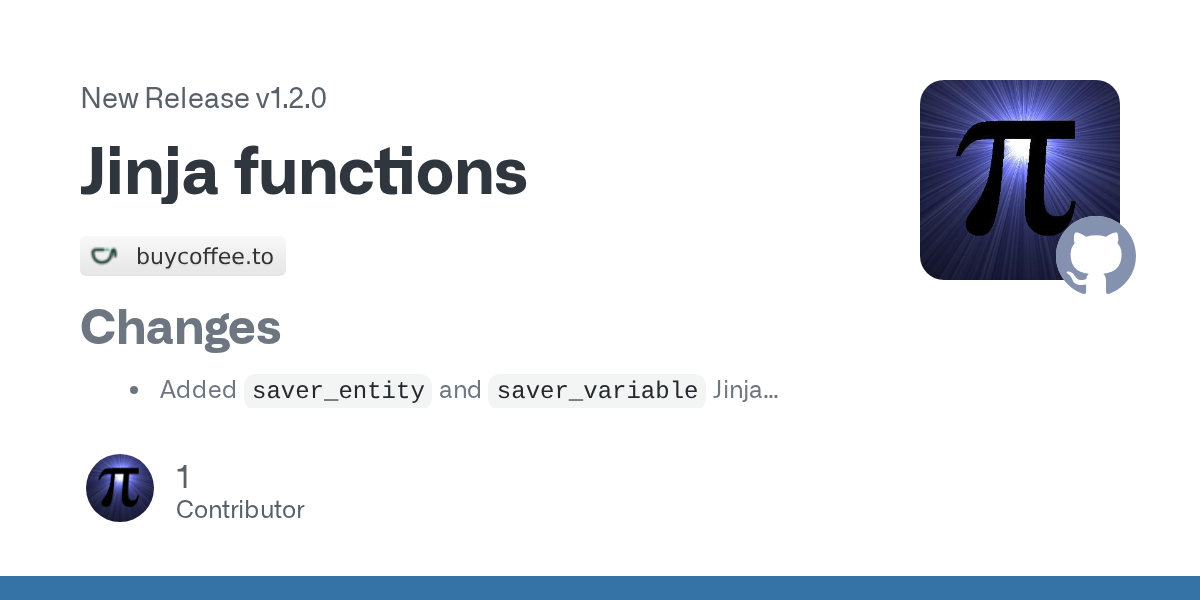

Release v1.2.0
  • Added saver_entity and saver_variable Jinja functions (to use instead of saver.restore_state and saver.execute services)
  • Added possibility to save/delete multiple entities at once
