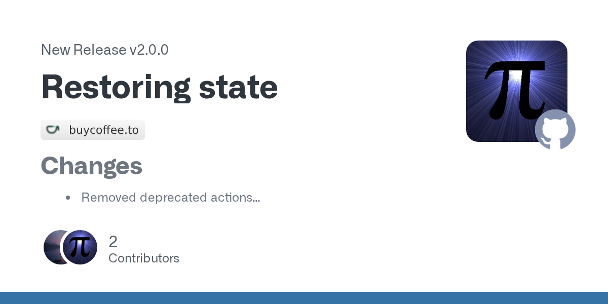

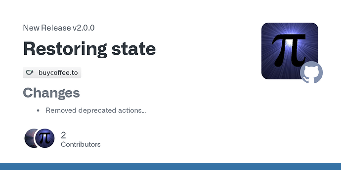

Saver v2.0.0
Now supports restoring states without manual scripts!
