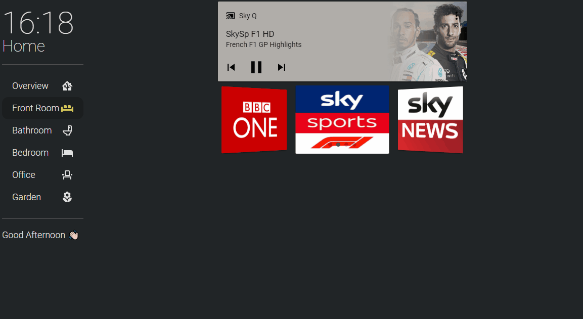

@RogTP the ability to show artwork for live shows is genius! Thanks for adding that in
