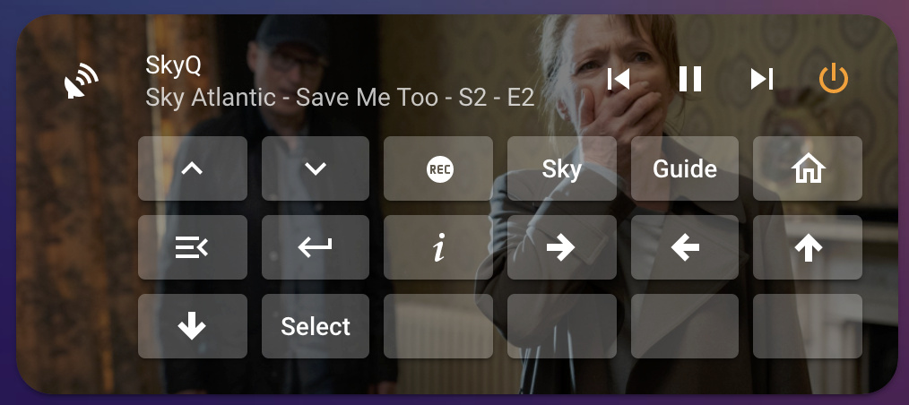

hey i am Tinni and i am completely new to home assistant but ive managed to add all my devices so far and trying to learn as much as i can but i am now stuck with this i have got the sky component running and working fine but i just can not figure out how to get the remote side of this i have gone over and over this thread but no idea i was hoping someone could point me in the right direction any help would be much appreciated
looking to do something similar to this one
Hi @tinni88, welcome. Where are you stuck? To configure the remote like you are showing you need to install mini media player, (you can find a link a few posts above), then configure it your Lovelace configuration (you can find some sample further up the thread).
Hi @RogTP thank you. I have all my cards running custom mini player card. Been using yaml mode to edit things and I’ve copied a few of the config’s above in to my Lovelace config’s editting them to match my setup but no matter what I do nothing seem to change in the UI and nothing in logs so I’m lost
I did have one configuration that popped up with a error in logs but I’m out at the moment so couldn’t tell you what it was but will post it up when I get back thanks for your reply:+1:
This is what I use to generate mine

that looks fantastic roger, i have just copied your config to mine changing to my entity and i get the error i was talking about in the log
