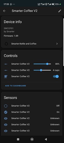

Alpha build available.
This isn’t a daily driver. It breaks some functionality, like services. That said, some coffee features should work. Please let me know, and do please show me a video
Thanks a million!! I was waiting for this for a long time!!! I’ll start the tests too, and report all behaviours :grin::heart:

Sorry, I left out the translations file, which is why you are seeing “None”. I pushed a new build.
It should also fix the switch issue you were having. It was not correctly mapping a default value (off) to the switch.
The reason is that there is not actually a flag explicitly for whether or not the coffee maker is currently brewing. Instead, there is a field “state”, which has values like “brewing” “cooling” “keeping warm”, “idle”.
For the kettle, I mapped “heating”, and “keeping warm” to “is_boiling”, because I think having a switch like this in the UI is helpful.
I have done likewise for the coffee maker. Maybe it makes sense, maybe it doesn’t :man_shrugging: . You can tell me.
