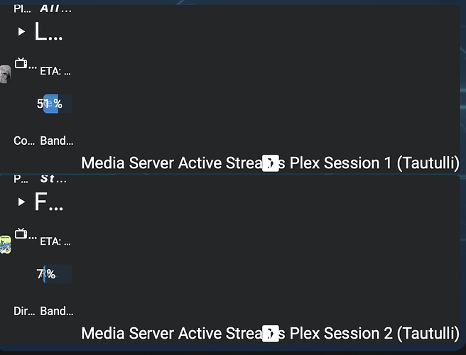

So Im on
Core 2025.85.3
Supervisor 2025.08.3
HASSOS 16.1

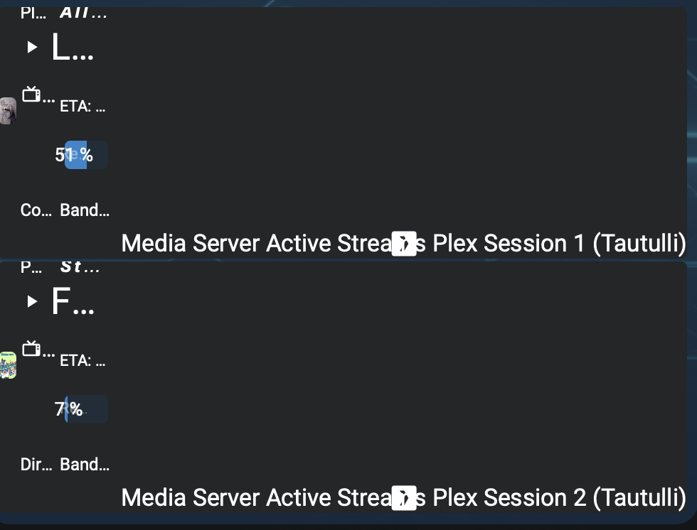

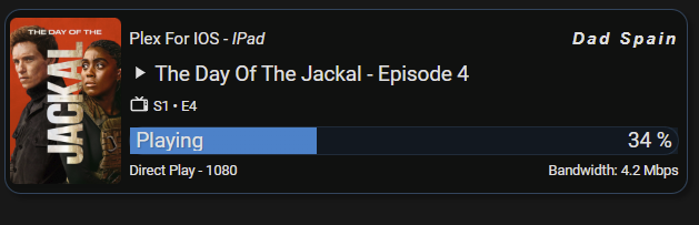

And recently I’ve noticed an oddity on the active stream info. as below
it starts off as usual…like this
then after a second or two, it changes to this and stays like it
I’ve not changed anything yet or reinstalled…as above, nothing has changed so wondering if anyone is seeing the same…so to clarify, all the requiredinfo is there,…theres just this big red errorbox throwing a spanner in the works

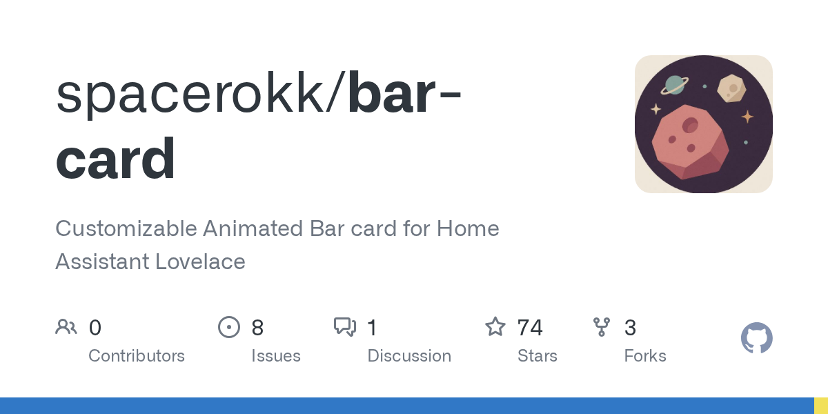

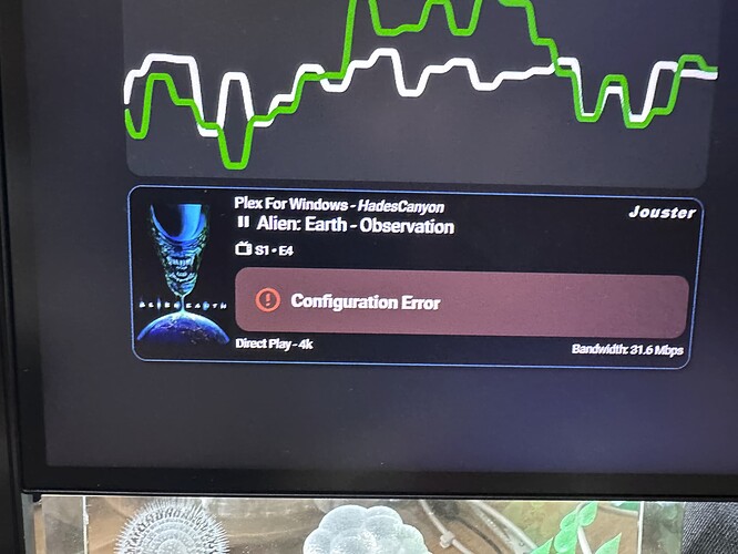

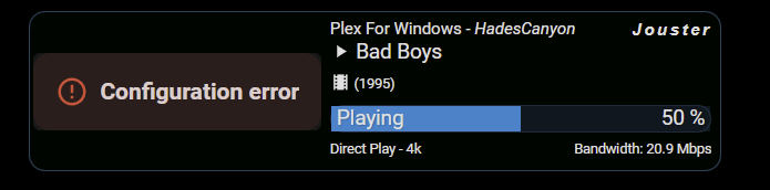

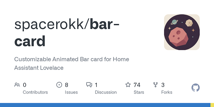

So it looks like the issue is that the Custom:Bar Card element, having been removed from HACS has broken things.
Removing that element from the config of the card element removes the config error but then you can’t see how far through the viewing is.
The original has been forked here
add it as a custom depository as the dashboard option and then it should work as expected
Hope this helps someone
All working again

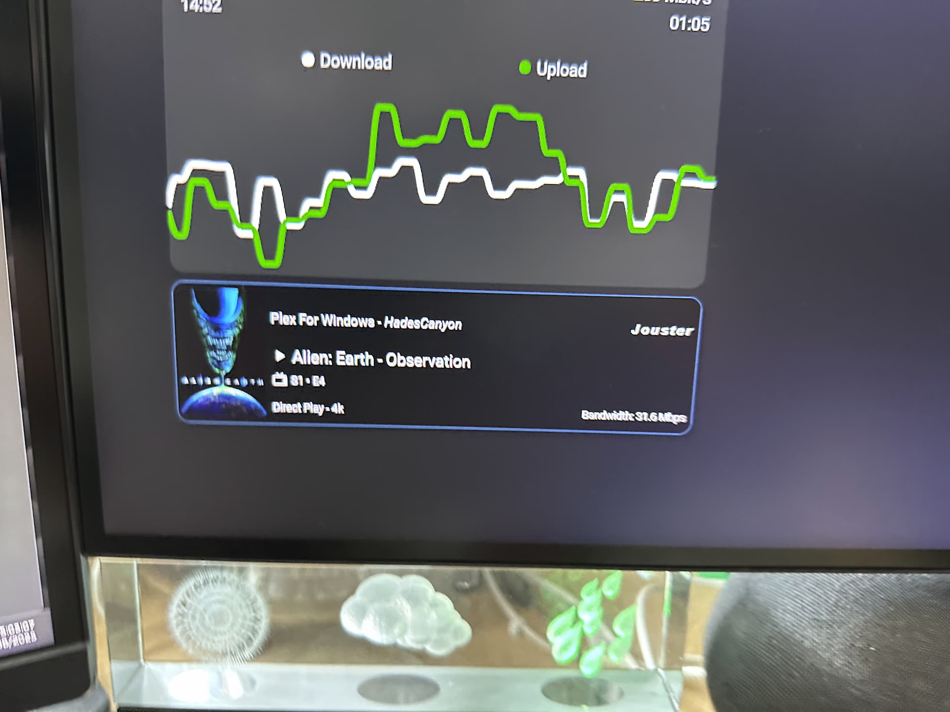

gskips
give this one a try. Merry Christmas!

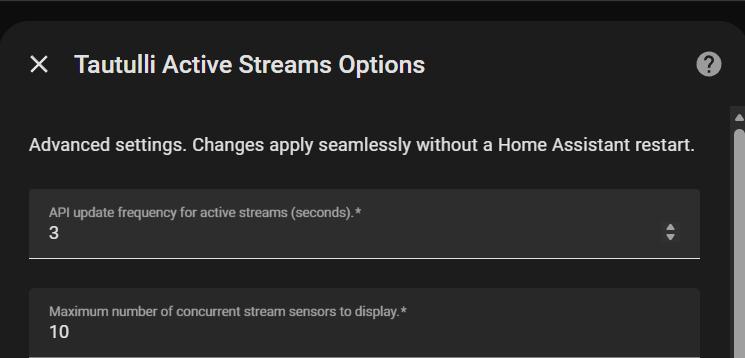

Sorry late getting to this… but THANK YOU sooo much… this is genius and exactly what I was looking for… really appreciated. Happy New Year!!
Though not a big deal, but, what is it that controls the update of this? It seems to do it every 10 secs or so… is there an easy way of increasing or reducing this update time… as I say, not a big deal, just wondering.
Thanks again!!!
the card update would be from the integration,
the active streams “api update frequency” this is how often you will get updates.
i have mine set at every 3 seconds,
