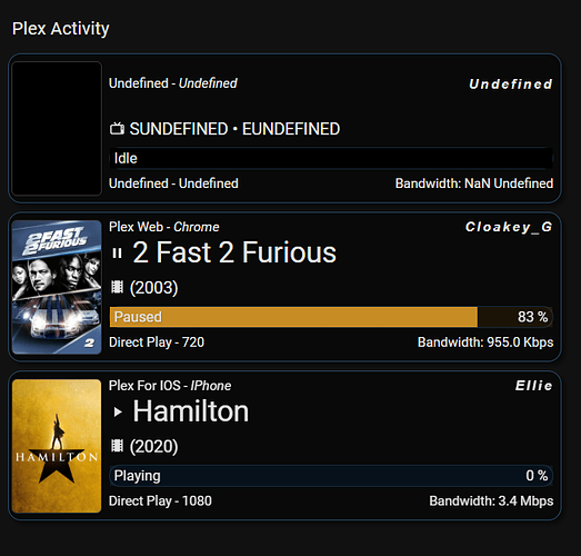

I see a blank undefined card at all times above the active cards
Nevermind. Got it working.
