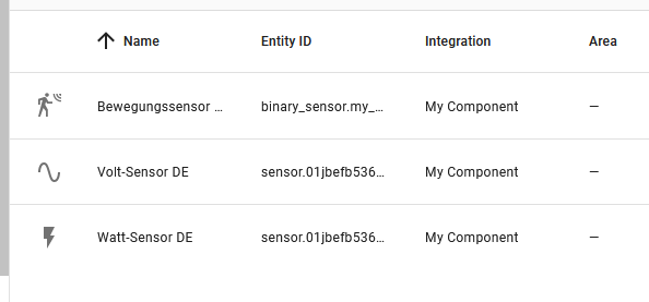

I can see it’s working. The entities are translated :+1:
screen
If I now switch to English, German is still displayed. Why is that?

Entity name translation is done based on server language not user language. You need to change the Settings → System → General language option.
I discovered this after having the same head scratching issue. Not sure why it is like this but possibly because if affects the entity id when creating.
