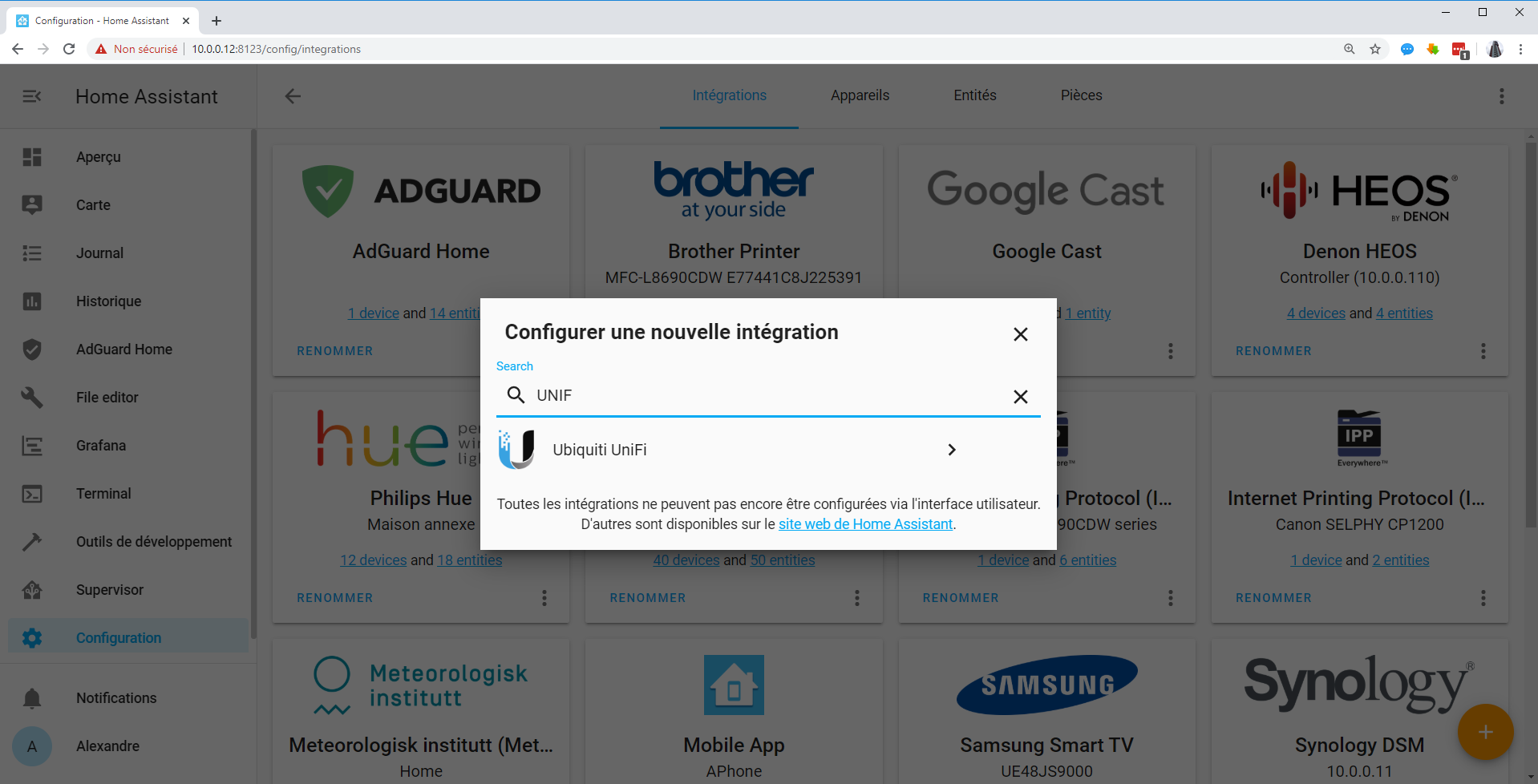

hello,
I can only find Unifi Ubiquiti in the HACS integration and not unifi protect. I’m using Home Assistant 0.109.6.
Am i missing something?
thanks

I don’t think this component is in the hacs store you have to add it manually. I do know Briis has everything well documented on his GitHub repo, go there and follow the steps.
Should be under “integrations” tab. Just search for Unifi, and you should see this:

Ah, that’s not HACS - That’s just the integrations page. Are you running HASS.IO? Or normal HomeAssistant?
Quick edit: unless you’re doing the new fancy version that @briis posted today
Second edit: Also forgot that it’s “Core HomeAssistant” (What I called “normal”) and “HomeAssistant Operating System” now (Not HASS.IO as I mentioned).
i’m not sure tbh! i used the image for Raspberry Pi 4 Model B 32bit
is this what you call HASS.IO ?
i will give a try to install HACS.
i’ve now removed the previous version of protect, and will (try to) install the 0.4.0 version
Sounds good! Yeah, that looks like “hass.io” (That’s what it used to be called, sorry).
If you need help, I’m happy to help! Should probably private message me though. Let me know!
