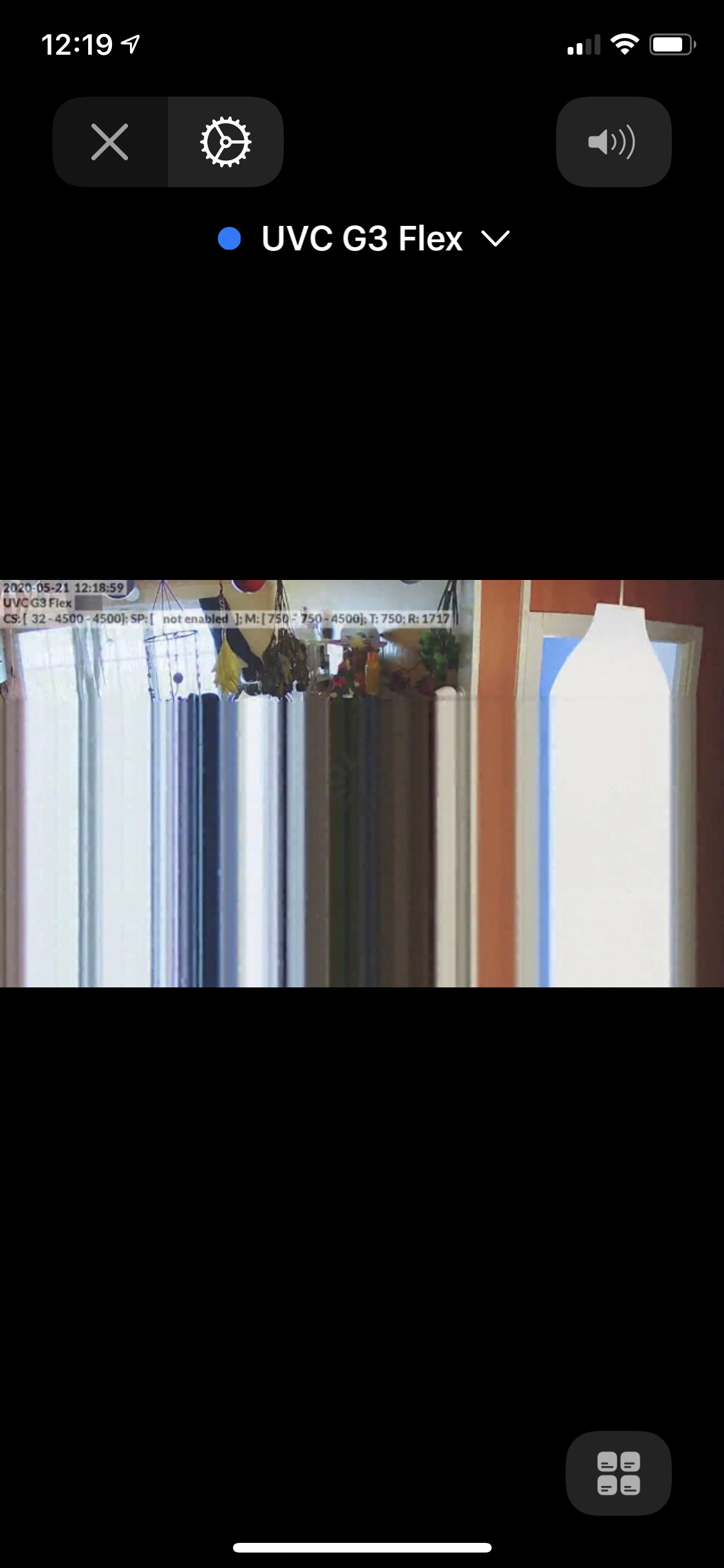

Hello I’m trying to get it to work white HomeKit is shows up in HomeKit app on my iPhone but it doesn’t look so good, can someone be so kind and test and if you get the same?, Watt codecs do it use?
Change the video codec to copy
