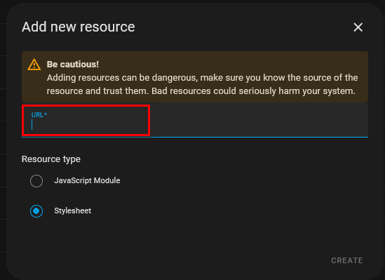

Let’s assume my css file is in:/config/www/custom.css
What to type here? What’s the correct path?
immagine
Use: /local/custom.css
See: Registering resources | Home Assistant Developer Docs
