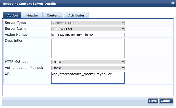

So, I use ClearPass as well to track devices, but I use radius accounting (starts and stops), long lived tokens to change the state of a device tracker in Clearpass:
First, I create an Endpoint Context Server pointing to my instance of HA by going to External Server> Endpoint Context Server
http method is post, authentication method is basic and the URL is /api/states/device_tracker.yourdevicename
Then I create a context server action by going to Administration> Dictionaries> Context Server action and create a new context server action:
On the header tab, I put Content-Type application/json, Authorization Bearer, a space and then the long lived access token from HA:
The content tab is as follows. Note that after completing these steps I have to duplicate this context server action and then change the state type for an action to set the device tracker state as “not_home”
I would just save it and then duplicate it and change the state to not_home like I mentioned above so that I can trigger my device as not_home.
I would then create an enforcement policy referencing the http action:
Lastly,In my service, I would just have an enforcement policy that checks for the mac address:
Connection:Client-Mac-Address-Colon EQUALS 9c:79:5c:ba:26:34) and then put in the Enforcement Policy that I created above.
