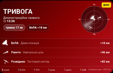

Hi everyone!
I’d like to share Air Threat Monitor , a custom Home Assistant integration created for users in Ukraine.
Honestly, this integration would never have existed if Ukraine had a normal neighbour instead of Russia. Unfortunately, air alerts, drones and missiles have become part of our daily reality. I wanted to make the most important information visible directly in Home Assistant, so my family could understand the situation quickly and react without opening several different applications.
Air Threat Monitor displays:
  • Local air-alert status for the selected district or oblast.
  • Alert start time and live duration.
  • Nearby reported aerial threats.
  • Distance, bearing, heading and approach direction.
  • Threat categories such as UAVs, FPV drones, reconnaissance drones, missiles and guided aerial bombs.
  • An animated radar with north-up or optional device-compass orientation.
  • Total and per-category target statistics.
  • Dynamic positioning using the current device GPS or a Home Assistant person /device_tracker .
  • Automatic location labels for dynamic positions.
  • Red/green signal styling and an alternative style that follows the Home Assistant light or dark theme.
  • A graphical card editor with safe and alert demonstration modes.
The integration is configured entirely through the Home Assistant interface. The radar card appears in the standard card picker, so no manual YAML is required for normal use.
Exact configured coordinates remain inside Home Assistant and are not sent to the data provider.

Привіт усім!
Хочу поділитися Air Threat Monitor — користувацькою інтеграцією Home Assistant для користувачів в Україні.
Відверто кажучи, ця інтеграція ніколи б не з’явилася, якби Україна мала нормального сусіда замість Росії. На жаль, повітряні тривоги, дрони та ракети стали частиною нашої щоденної реальності. Мені хотілося бачити найважливішу інформацію безпосередньо в Home Assistant, щоб моя сім’я могла швидко оцінити ситуацію та відреагувати без відкривання кількох різних застосунків.
Air Threat Monitor показує:
  • Стан повітряної тривоги для вибраного району або області.
  • Час початку та поточну тривалість тривоги.
  • Найближчі зафіксовані повітряні цілі.
  • Відстань, напрямок, курс і характер руху цілі.
  • Категорії цілей: БпЛА, FPV-дрони, розвідники, ракети та КАБ.
  • Анімований радар із північчю вгорі або орієнтацією за компасом пристрою.
  • Загальну кількість цілей і статистику за категоріями.
  • Динамічну позицію через GPS поточного пристрою або сутність person /device_tracker .
  • Автоматичне визначення назви поточного населеного пункту.
  • Червоно-зелене сигнальне оформлення та нейтральний стиль відповідно до теми Home Assistant.
  • Графічний редактор картки з безпечним демонстраційним режимом.
Інтеграція повністю налаштовується через інтерфейс Home Assistant. Картка автоматично з’являється у стандартному каталозі карток, тому для звичайного використання вручну писати YAML не потрібно.
Точні координати залишаються всередині Home Assistant і не передаються постачальнику даних.
