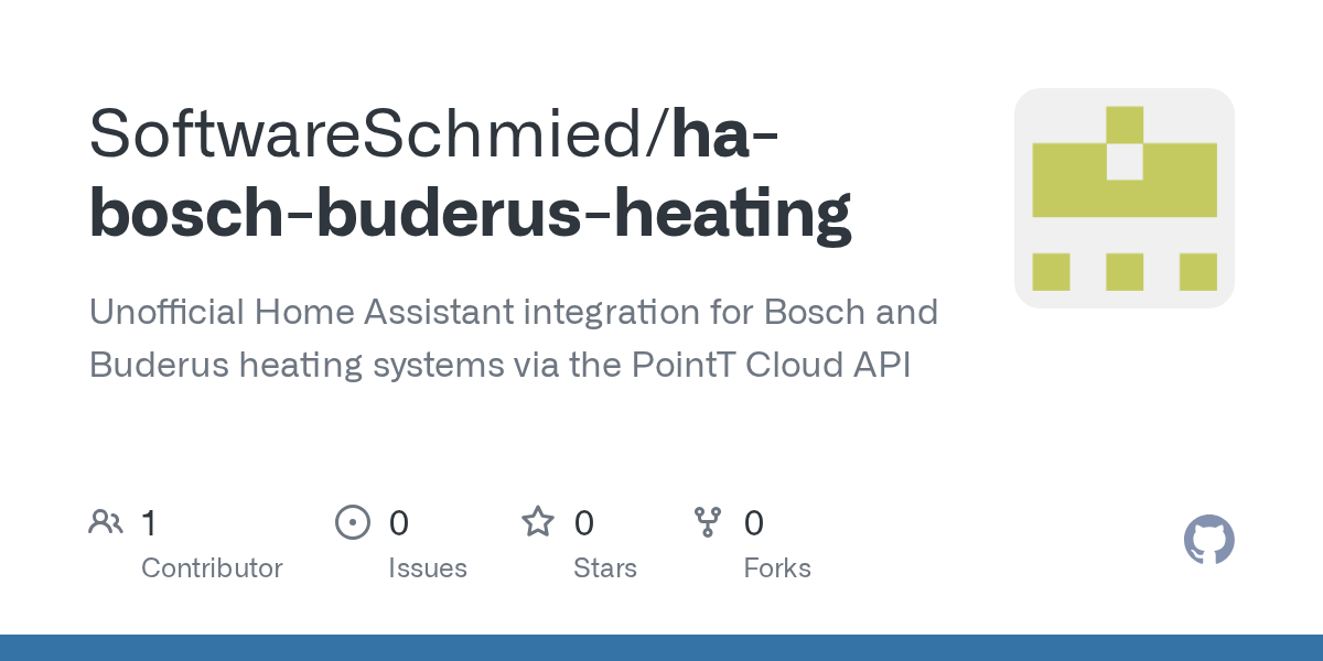

Repository:

Installation
The integration is awaiting inclusion in the default HACS catalog under pull
request #10040.
Until then, install it as a custom HACS repository:
  1. Open HACS.
  2. Open the three-dot menu and select Custom repositories.
  3. Add:
    https://github.com/SoftwareSchmied/ha-bosch-buderus-heating
  4. Select Integration as the category.
  5. Install Bosch/Buderus Heating.
  6. Restart Home Assistant.
  7. Open Settings → Devices & services → Add integration.
  8. Search for Bosch/Buderus Heating.
