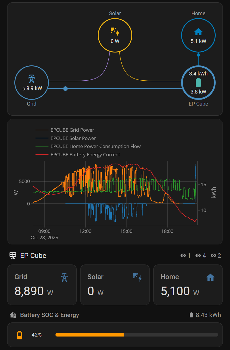

This is how I’m visualizing the EP Cube stuff in my HA.
I did see a grid outage earlier today and the General State went to 0, so I believe this is being used by the EP Cube App to determine the “Normal” or “Fault” text in the upper left with 1 being “Normal”.
For the System Status all I’ve seen so far is that it seems to be 4 when the inverter is active in some form either charging or discharging, and 6 when the inverter is inactive (i.e. the battery is 100% and just running from the grid). The Work Status I’ve never seen change from a 2.

Your dashboard for the EP Cube is very impressive is it possible to share how you created this? I have the official Canadian Solar integration installed.
