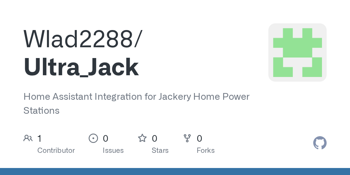

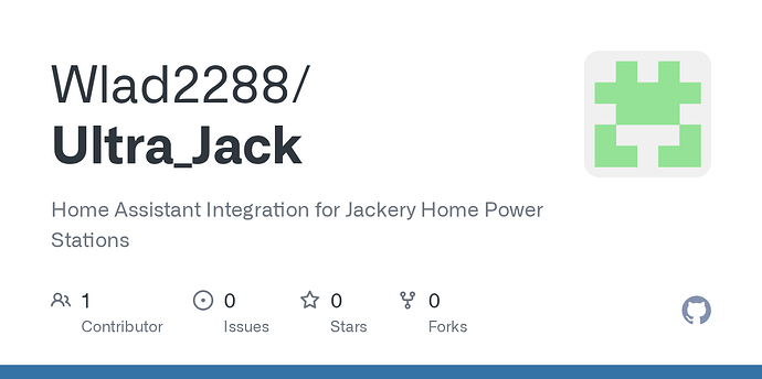

That is exactly what I am looking for. Unfortunately it is not compatible with my 2000 Ultra.
However with the help of claude.ai I managed to develop my own custom integration which works for my Jackery 2000 Ultra. The first version of the integration shows the SOC, available capacity and Input/Output AC Power.
