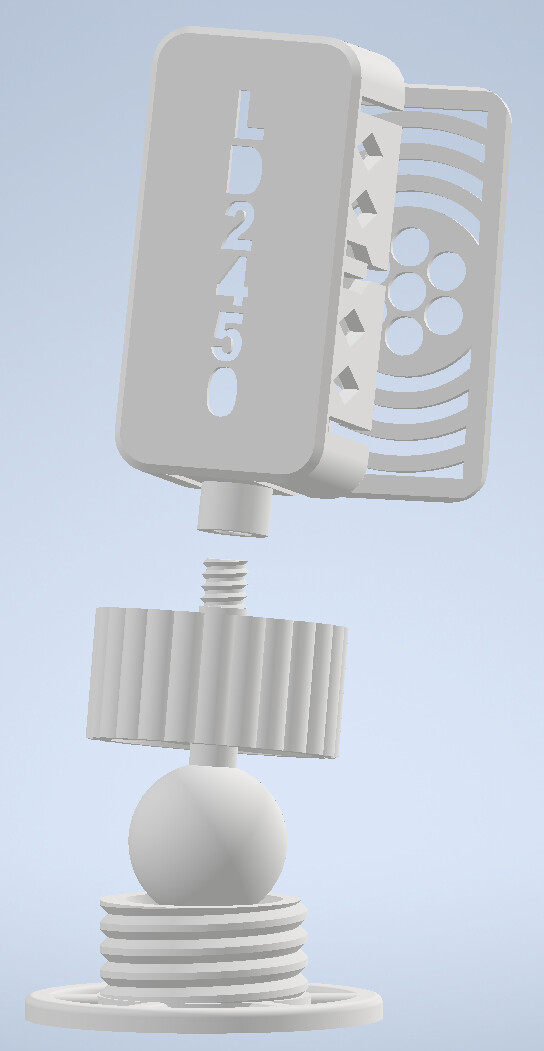

Bonus: a 3d model for a sensor’s case (yes, i was getting bored :smiley: )

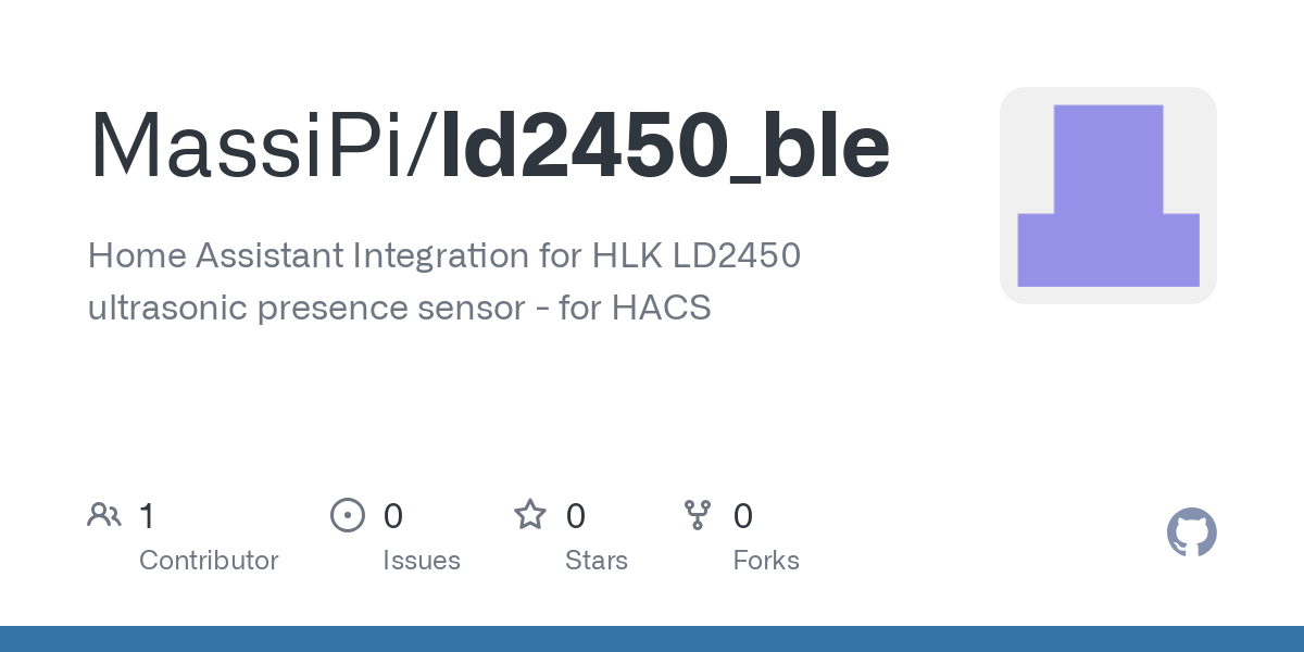

Just add the repo address to hacs to install che integration
Link to repo:

question for the makers out there :slight_smile: any better idea for the support connection of the 3d model?
i printed it in pla and it tends to relax after some days giving no more solid block of the sensor
I could add another arm to the support, but i’m quite sure i’m just gaining some more time and not solving the issue

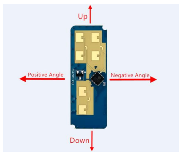

Is there a reason why you put the sensor sideways(3D Model)?
Usually the 4 “Antennas” are pointing upwards and the 2 Antennas downwards…
Or am i wrong?
M.
no reason, i didn’t even think about that, but in the datasheet it is as you say
i should probably create a full new model (in the old one if you print in PLA the support relaxes quite soon and you cant guarantee the sensor to be blocked anywhere…)
thanks for pointing this out :slight_smile:

I just did a brand new support for the sensor (now it’s not getting uncontrollable with time) and vertical.

eventually, i created the hacs integration file and prepared the repository :slight_smile:
just add the custom repository address to hacs
