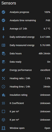

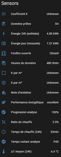

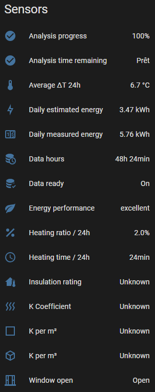

Other than ‘Performance énergétique - excellent’ what does it tell me?

Apologies for all these questions - I’d just like to see, if I can get it to work for one zone before I dive into adding the 2nd zone or split it up - as I mentioned above - into several sub-zones.
Thanks for the detailed feedback! I see several issues:
Why K coefficient is Unknown:
Your average ΔT is 4.3°C, which is below our 5°C minimum threshold. The integration needs at least 5°C difference between indoor and outdoor temperatures to calculate reliable K values. This is common in mild weather or well-heated homes.
Surface/Volume:
These are optional - you don’t need them for basic analysis
Surface gives you K/m² (useful for comparing rooms)
Volume gives you K/m³ (used for insulation rating)
You can estimate volume as: surface × ceiling_height (typically 2.5m or 8ft)

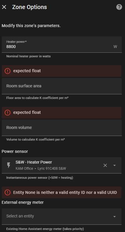

The “expected float” errors:
This looks like a bug in the options form. Can you try:
Delete the zone
Re-add it with surface/volume filled in during initial setup (not in options)

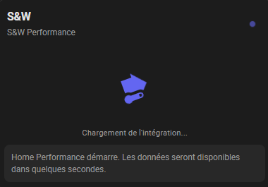

Card stuck on loading:
This happens because K is not calculated yet (ΔT too low). The card should show a “waiting” message instead of spinning forever - I’ll fix this.
Questions:
What are your typical indoor/outdoor temperatures?
When you have a cold day (ΔT > 5°C), the K should calculate automatically.

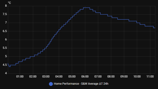

Just a hint:

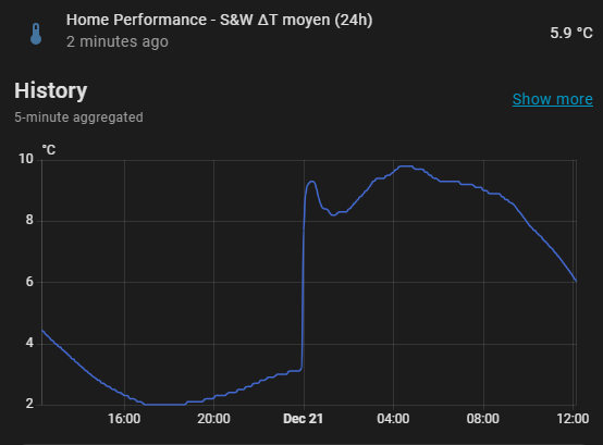

You might want to look into the delta-T calculation.
It shows ΔT > 5°C, but if this should result in the calculation of a K-Coefficient, it might actually display a Fahrenheit number here.
Also:
Nut sure where that jump at midnight is supposed to come from and what it means:
Thanks for the detailed feedback! I’ve created 3 issues based on your observations:
#16 - Entity names always in French (i18n not working)
#17 - ΔT sensor missing device_class (no °C to °F conversion)
#18 - Midnight jump in ΔT graph (reset vs rolling average)
I’m currently working on #16 and #17 - these fixes are almost ready and will be included in the next release. The translations will display properly in English, and ΔT will automatically convert to °F for fahrenheit users.
For #18 (the midnight jump), it’s a visual quirk but doesn’t affect calculations. It’s lower priority and planned for a future update.

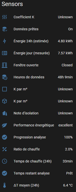

Also, not sure why the ΔT 24h entity still shows °C - shouldn’t that be °F by now?
If so, I assume the ΔT needs to be above 9°F instead of 5°C, correct?

K Coefficient = Unknown
This is not a bug - it’s working as designed. The integration requires at least 30 minutes of heating time per 24h period to calculate K reliably. Your furnace ran only 24 minutes (2%), which is below the threshold.
Fast-cycling US furnaces are very powerful and often heat in short bursts, which can be below our threshold. We’re considering making this configurable in a future release.
