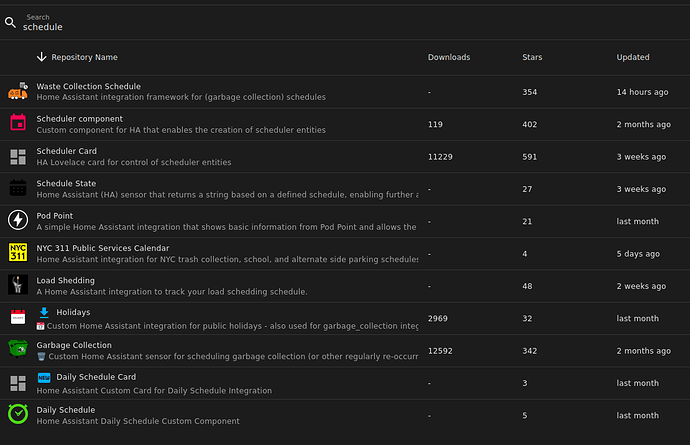

Option 2: do you know HACS https://hacs.xyz/?
On HACS I see existing schedule custom_components, do they meet your requirements?
