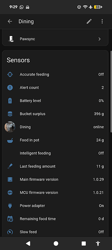

Not sure if whatisjason is still looking at this or interested in maintaining it, but I vibe coded a fix to use multiple sensors and sent a pull request.
This is awesome — huge thanks to Jason for building this foundation! I actually bugged Pawsync shortly after buying the feeder telling them they should make an official HA integration. I even spent an evening with ChatGPT trying to read Wireshark packet captures to figure it out, but it was way above my pay grade and patience level at that time.
I’m an old fart and my better coding days are 30 years in the past, so I rely on Claude Code to do the heavy lifting these days. I ended up vibe coding like a madman and going pretty deep on it — wanted to share what came out of it. I also incorporated the two open PRs — credit to @tomsalden for the session stability fix (PR #2) and @asssaf for the sensor entity pattern (PR #1).
To get the API method names right I actually had to patch the APK to bypass certificate pinning and run mitmproxy to sniff the app traffic. Worth it!
Bug fixes (on top of the original):
  • Sensor values frozen at startup and never updating
  • Bad passwords silently creating a broken config entry with no error
  • Phone app getting logged out after every HA restart (PR #2’s fix — incorporated)
  • Feed errors from the API silently ignored
  • Auth token printed to HA logs on every feed request
  • Switches reverting immediately after being toggled
  • Sleep Mode toggle silently rejected by the device (needed start/end times in the payload)
  • “Food in bowl” showing stale server-cached data instead of live scale reading
New features:
  • Options flow — update credentials, units, meal size, and polling interval via the gear icon without removing the integration
  • 4 switches — Smart Feeding, Slow Feeding, Precision Mode, Sleep Mode; all controllable from dashboards and automations
  • 5 buttons — Extra Meal, Zero Scale, Meal Call, Reset Desiccant, Refresh
  • Sleep mode schedule — two time picker entities (start/end) so you can automate different weekday vs weekend quiet hours from HA
  • Live bowl weight — “Food in bowl” now reads the real-time scale via getPetDeviceStatus instead of stale server data
  • Hopper level control — slider to record food level after refilling (1–3.6L); automatically updates the food supply remaining days estimate
  • Pet log sensors — last dispensed time/amount, last eaten time/amount, last eating duration
  • Pet profile sensors — named after your pet (e.g. “Finn Weight”) with their avatar photo as the entity icon; weight, daily intake, food target, feedings today
  • Desiccant remaining sensor and Reset Desiccant button
  • Food bowl binary sensor — OK when placed, Problem when removed; great for automations
  • Firmware update binary sensor — turns on when an update is available, attributes show version and release notes
  • US/metric toggle — all weight sensors in oz or grams, defaults to US
  • Dynamic entity discovery — new feeders appear automatically without restarting HA
  • HACS-compatible with one-click install
