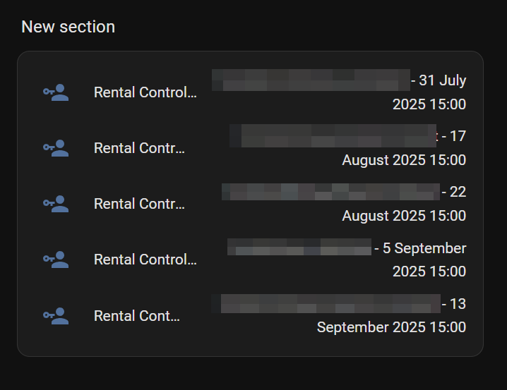

Yes calendar.rental_control_x is the calendar that RC is actually tracking for things. If you pull up the calendar sidebar in Home Assistant you’ll see the calendar there. All guest bookings from the platform (Airbnb in your case) will show up there. Please note, Airbnb removes finished bookings from the exported calendar so the only way to see past booking dates is on Airbnb itself.

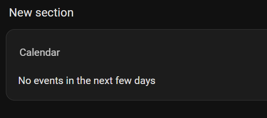

i must try it. at the moment i see only
with you code :slight_smile:
1/4
Figures, I didn’t actually test the code I gave you. I forgot that Atomic Calendar doesn’t do auto-entities globing. You have to explicitly add each calendar entity to it that you want to track. Just add several entity stanzas and you’ll be fine
