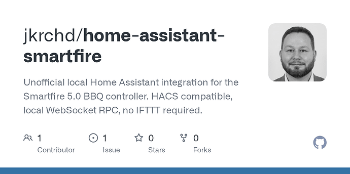

[Custom Integration] Smartfire 5.0 BBQ Controller – local LAN integration (HACS)
Hi everyone,
I’d like to share a new unofficial Home Assistant custom integration for the Smartfire 5.0 BBQ controller.
:fire: Smartfire 5.0 for Home Assistant
GitHub:
The integration communicates directly with the Smartfire controller over the local network using its WebSocket RPC interface.
No IFTTT webhook is required for sensor updates, and normal sensor operation does not depend on the Smartfire cloud.

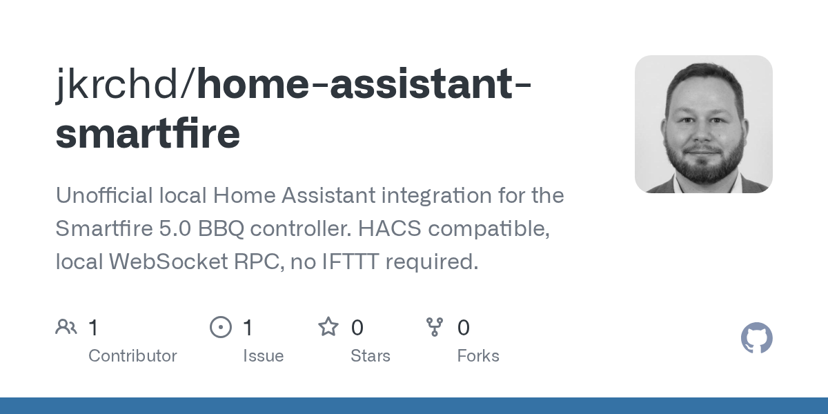

Protocol documentation
I’ve started documenting the locally observed protocol here:
I’m trying to distinguish clearly between confirmed behaviour and anything that is still experimental.
