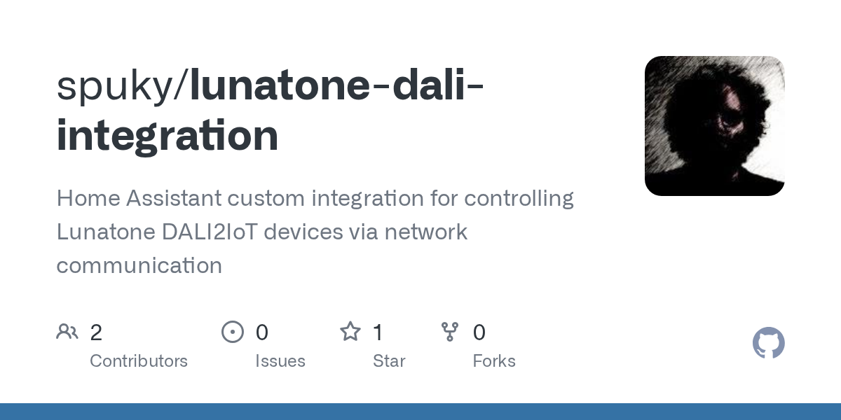

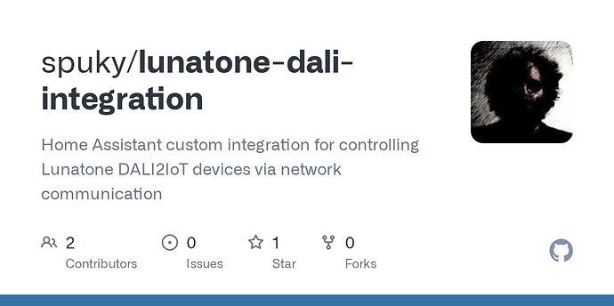

Claude code and me developed an Integration for Lunatone Dali2IoT
Would love to have some people testing it… since I got only 12 of the same Lights that can only Dim… and it would be nice to know if features like RGB actually work…
