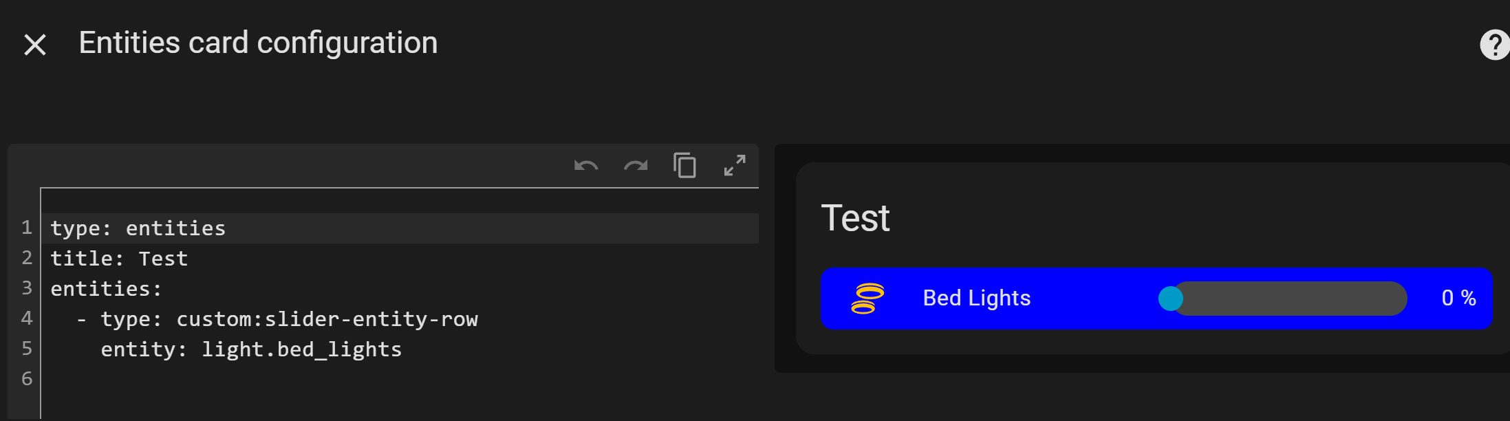

It doesn’t work for me?.. The following are the changes I made to your code:
let backupCSSFn;
function modifyElementStyles(elementName, newStylesFn) {
  return customElements
    .whenDefined(elementName)
    .then(() => {
      const UIElement = customElements.get(elementName);
      if (!UIElement) {
        console.error(`Custom element ${elementName} not found`);
        return;
      const css = UIElement.prototype.css || backupCSSFn;
      if (!backupCSSFn && UIElement.prototype.css) {
        backupCSSFn = UIElement.prototype.css
      if (!css) {
        throw "No CSS function";
      const newStyle = newStylesFn(css);
      const combinedStyles = UIElement.styles
        ? [].concat(UIElement.styles, newStyle)
        : [newStyle];
      Object.defineProperties(UIElement, {
        styles: {
          value: combinedStyles,
          configurable: true,
          enumerable: false,
        elementStyles: {
          configurable: true,
          enumerable: false,
      console.log(`Styles applied successfully to ${elementName}`);
    .catch((err) =>
      console.error(`Failed to modify styles for ${elementName}:`, err)
const styleDefinitions = [
    styles: (css) => css`
      .wrapper {
        --ha-slider-track-size: 2px;
        --primary-color: rgb(0,100,255);
        --disabled-color: Silver;
        padding-left: 15px;
        padding-right: 15px;
Promise.all(
  styleDefinitions.map(({ name, styles }) => modifyElementStyles(name, styles))
  .then(() => console.log("All custom styles applied successfully"))
  .catch((err) => console.error("Error applying custom styles:", err));

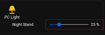

This name: "slider-entity-row", will not work as a stand alone CSS style from my experience. You can use this until I research why it does that for this specific card type…
let backupCSSFn;
    .then(() => {
      if (!UIElement) {
        return;
      if (!css) {
        : [newStyle];
        styles: {
          configurable: true,
          enumerable: false,
        elementStyles: {
          configurable: true,
          enumerable: false,
    .catch((err) =>
     :host {
      .wrapper {
        padding-left: 15px;
        border: 1px solid red;
Promise.all(
This is the results inside a custom:button-card
