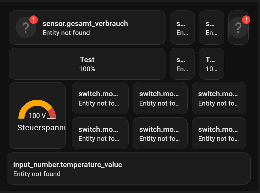

Hello everyone,
I have a general question about the custom:layout-card. I am currently using this card to create a tidy layout. I only use this card on the dashboard occasionally to achieve certain alignments of the elements.
I most often use the custom:layout-card in conjunction with the Vertical-Stack or Horizontal-Stack card. I have noticed that the card on the dashboard gets smaller when it is created with the custom:layout-card. It seems to add a frame that slightly compresses the inner elements. This creates larger gaps between the cards, but only where the custom:layout-card is used. This looks very unsightly as it appears unevenly distributed.
Is there a command or a workaround that can help with this problem?
If no one understands my concern, I will create a screenshot later and show you the code. However, I can imagine that you might have already noticed this too.
I hope you can help me.
Best regards

Can you provide a card example?
For the dashboard, I added width and max_cols and it is nicely distributing horizontally. I cannto confirm/recall reduced vertical size
Thank you! The margin command helped a bit, but it is not completely OK.
Here is the code, sorry because its rather long, but I deleted as much as I could.

And here I have a screenshot for you, it is 2x the card from the code above. The upper variant is without the margin-command, the second (blue marked) ist with the margin command.
It is better, but I still have problems with the “border” of the custom:layout-card.
I’ll mess with a few options but it’s possible to get it tighter

needs work…
Thank you very much for this!
Looks much better, although it seems, this might be some work to get it a perfect look.
But when I use pixel-values for the margin command, then it will look different at different Monitors, right?
Do you know the reason, why the cards get smaller? For me, this looks like a bug…
Not a bug, each card has padding and margins that come into play
When stacking cards the margin an padding add up
