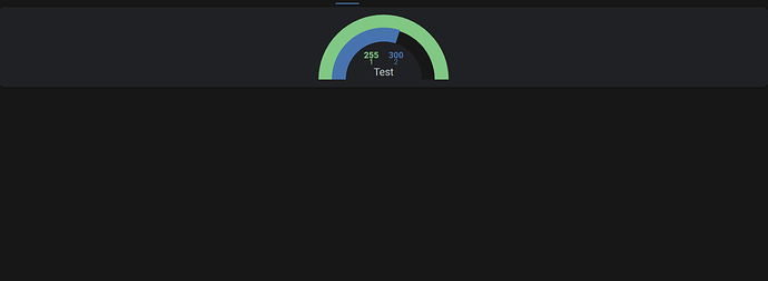

Great work! I have two questions which im struggling with and where i hope you could help.
One big thing im missing is a lock feature just like with the button card. With this i can prevent that me or my wife push something we donât want to push by accident. Is this something you are going to add?
Secondly, is it possible to combine the homekit card together with other cards on the same view? I found one workaround with the layout card but then my layout is screwed with homekit. What i want to do is to combine the homekit buttons for my lights and use double gauge card for example to show the current brightness/colortemp variable for circadian values
It keeps throwing errors at me or isnât showing the homekit card, see below my test code:

When i include it into a homekit card itâs not showing correctly

value: 300

Thx for this post. Was pulling my hair on this one. Had no icons showing untill i used this.
This is the code in total im using on the Card
