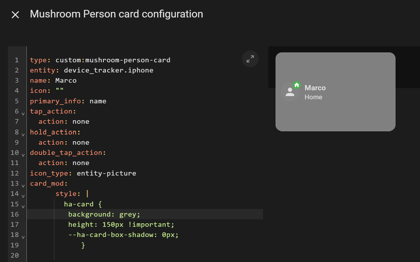

The result does not change, the image is squized but I receive an errore (alert) also:
Visual editor not supported
At path: card_mod -- Expected a value of type `never`, but received: `[object Object]`
Puoi ancora modificare la tua configurazione in YAML.
as you can see in the picture below:
Can you help me, please?

I added grey to the background to highlight the card_mod is working
The OP wanted the card taller. Marco wanted the icon bigger.
That would just need these lines added to the mod
--icon-symbol-size: 40px;
--icon-size: 60px;
