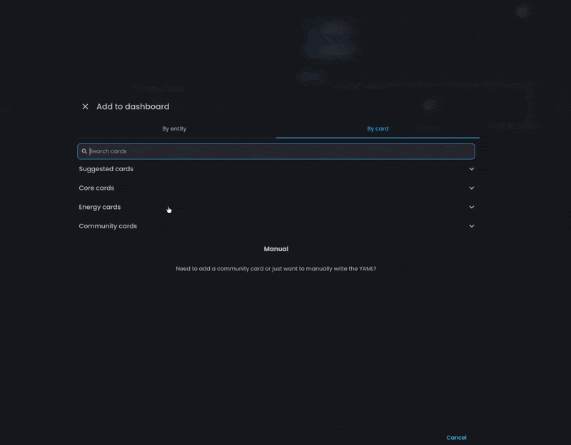

It works by first switching the card picker to the ‘Card’ tab and collapsing all the panels.

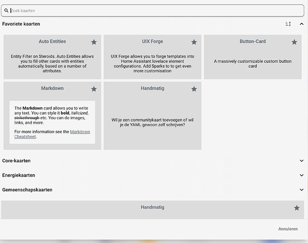

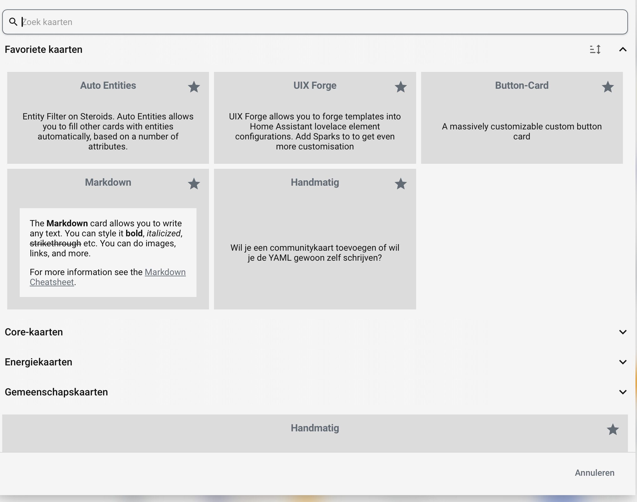

(btw I have the manual card set as favorite, and it still opens with the manual card all the way down. suppose opening favorites by default would indeed be best, and not opening manual at the bottom?)
Have you updated the script, as mentioned above? :grimacing:
CleanShot 2026-08-12 at 12.37.10

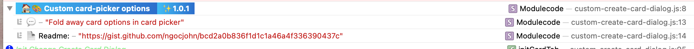

btw I updated and added some consoling :wink:
const name = "Custom card-picker options";
const version = "1.0.1";
const description = "Fold away card options in card picker";
const repo = "https://gist.github.com/ngocjohn/bcd2a0b836f1d1c1a46a4f336390437c";
const badgeStyle =
  "color:white;background:linear-gradient(90deg,#41BDF5,#2C6ECB);padding:2px 8px;font-weight:bold;";
console.groupCollapsed(
  `%c🏠🎨 ${name} %c✨${version}`,
  badgeStyle,
  badgeStyle
console.log("💬", description);
console.log("📄 Readme:", repo);
console.groupEnd();
it now opens the favorites alright, but the bottom manual card is still there
let me ask a mod to move this to a new thread from #526, it’s really polluting here
Because manual isn’t in the expansion panel…
