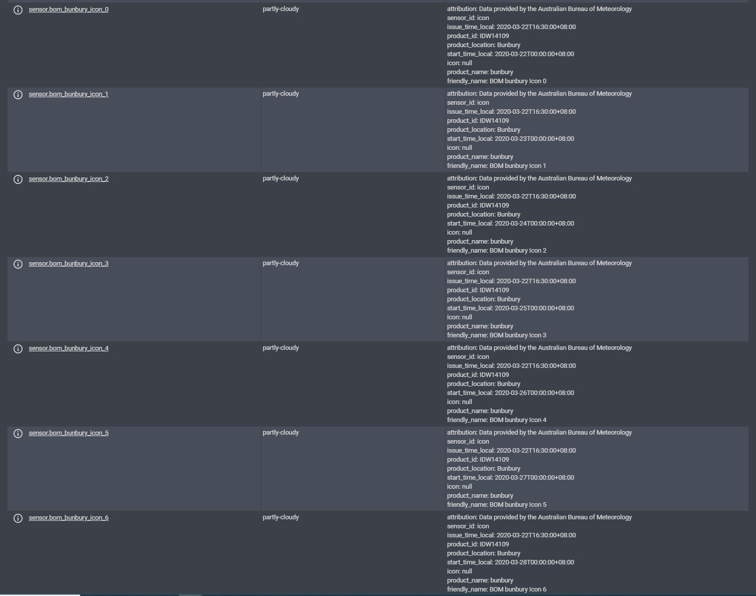

Can you check dev-tools and see what the state is for all these: sensor.bom_bunbury_icon_1
sensor.bom_bunbury_icon_2
sensor.bom_bunbury_icon_3
sensor.bom_bunbury_icon_4
sensor.bom_bunbury_icon_5
Sorry I can’t find that in the chrome dev condole.
I have these errors though
bom-weather-card.js:836 Uncaught (in promise) ReferenceError: popunit is not defined
at bom-weather-card.js:836
at Array.forEach (<anonymous>)
at HTMLElement.updateValues (bom-weather-card.js:830)
at HTMLElement.set hass [as hass] (bom-weather-card.js:812)
In Home Assistant all of the entities show the same forecast icon

Not in chrome… in Home Assistant - Developer side panel and states…
What is the state of al those entities?
So the state is the same for all entities hence the icon displayed is the same as well.
Yes it is but the FTP component is reporting the state for all of them as Partly Cloudy… The card is displaying as I would expect.

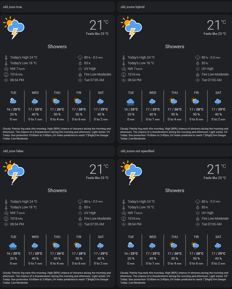

Hi David, is there any way to make 5 day forecast have day icons all the time as i believe that this is the next days forecast not night?
Kind Regards,
Simon
It would be a huge undertaking to do that. It currently determines if it’s day or night and then sets all the icons for that if they have a night version. There’s little gain in the major rewrite for that. If you want you could copy the day version of the icon over the night one and then it would always use the day icons.
I thought as much. Thanks.
Pushed a new release that will do hybrid icons (a mix of old and new ones). Uses the old icons for everything except fog, haze, dust and windy where it will use the new ones.
If the old_icon flag isn’t specified it will default to true.
