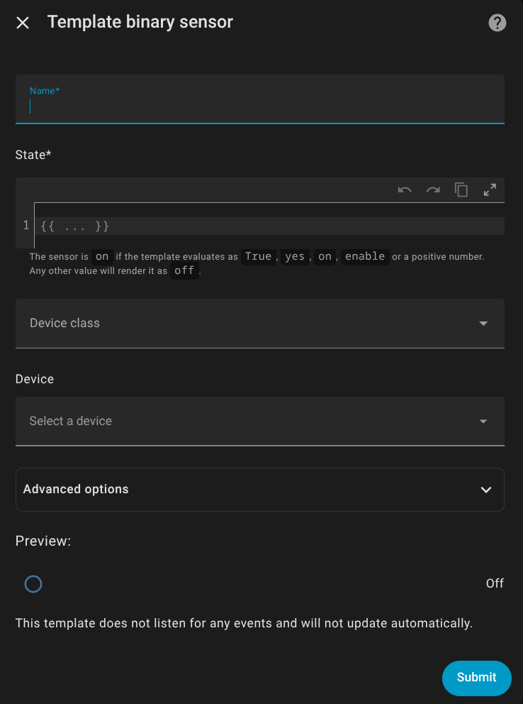

Hello, I’m trying to replicate this in HA 2025.12.1. When I go to create a binary sensor I am presented with the following UI.
The only fields where I could put in the code above are “State” and “Availability template” under Advanced options. When I put the code in either one of them, I get the message “This field is intended for templates only (e.g. {{ states(sensor.test) > 0 }} ).”
Any help is greatly appreciated!
those options are not available in the UI, and require a YAML configured template
Thanks. Does that mean I have to paste the code in a configuration.yaml file or something like that?
Correct.
Just check the documentation how .
