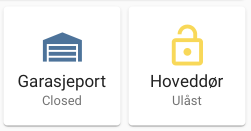

I still need to customize the Lovelace icon in the Button card, though.

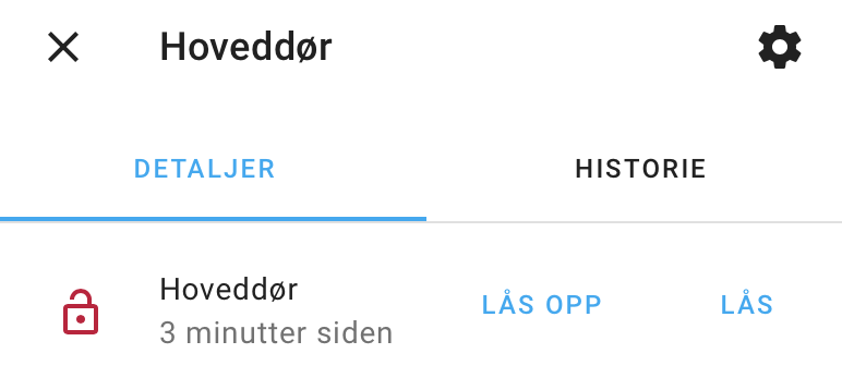

Skjermbilde 2020-11-13 kl. 10.37.35
Now it seems to stick to the usual theme color in Lovelace buttons, while the icon color is changing in the state window as shown below.
of course, depending on your custom card styling, you need to change settings. custom-ui sets the entities properties, not the custom card functionality. Though, the customized icon should show if you dont use any setting at all in the button card.
does it work in a regular entities card for those 2 ? (suppose it does considering the more-info popup you have)
Yes. In a standard entities card it works fine.
Both icon and icon color changes according to state.
How can I get this same behavior in the button card?

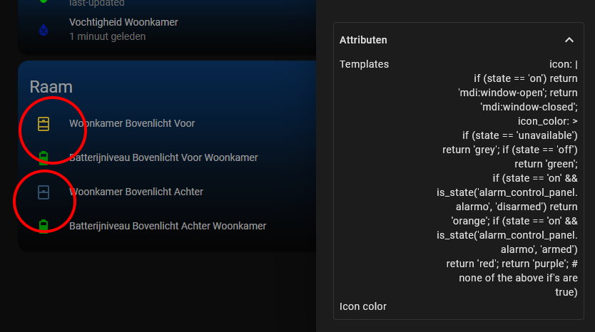

Hello Marius,
Thanks for the reply, tried your solution, sorry but it didnt work.
first yes I Installed custom_ui
second, I think the whole is_state function is not supported somehow.
After I applied your solution the icons defaulted to the theme schema.
excuse the naming ‘Bovenlicht’ it has nothing to do with lamps or lights it simply refers to the upper
window.
as you can see the icon color gets no value at all, even not the purple value you suggested, the yellow and blue-ish are default theme colors. they do change if open (upper yellow icon) or closed (middle blue-ish icon), so part of it is working.
any other ideas?
Regards Frank
i m so sorry, I wrote way too fast and used the jinja ‘is_state()’ function… (copied from your own post). This can not be used of course… we need JS templates. duh.
  icon_color: >
    if (state == 'unavailable') return 'grey';
    if (state == 'off') return 'green';
    if (state == 'on' && entities['alarm_control_panel.alarmo'].state == 'disarmed') return 'orange';
    if (state == 'on' && entities['alarm_control_panel.alarmo'].state == 'armed') return 'red';
    return 'purple'; # none of the above if's are true)
