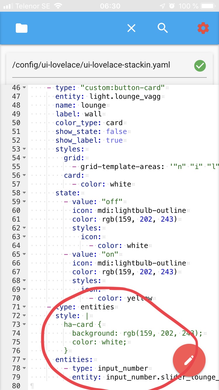

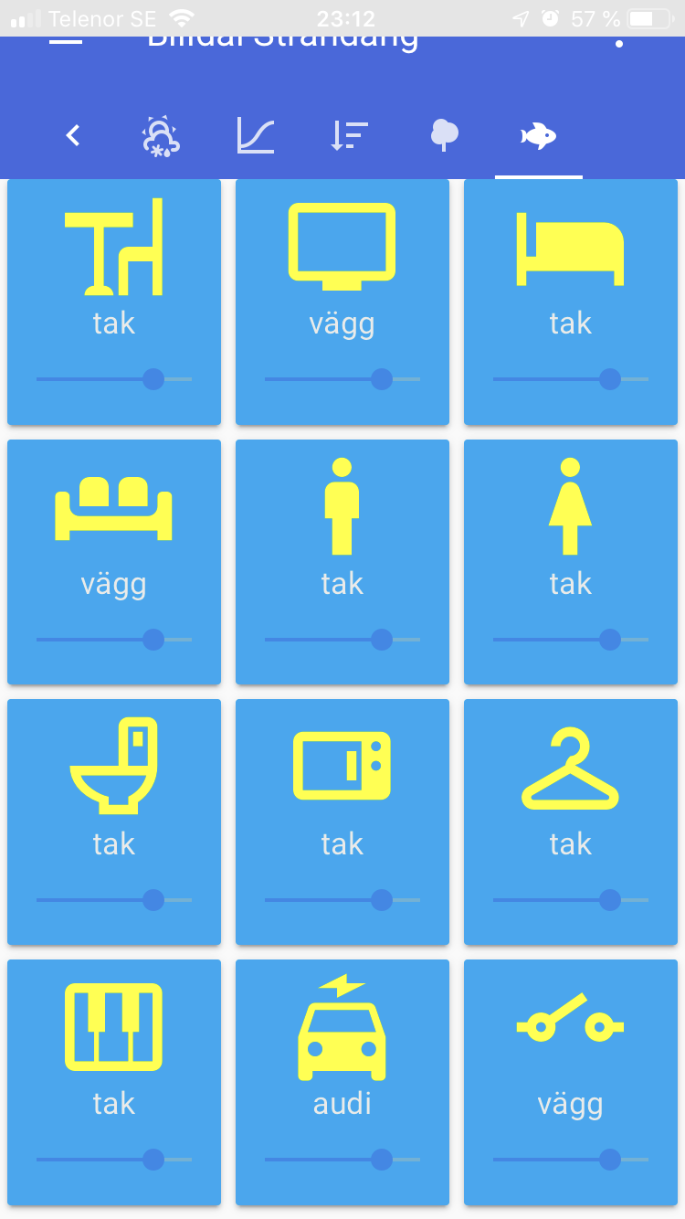

I have merged two cards (slider-entity-row and button-card) by using vertical-stack-in-card. I have then customized slider-entity-row (color) with card-mod.
What I would like to do is modify the slider-entity-row further to reduce its height and change color of the slider and knob.
Any ideas on how to do that? I have localized some ha and var elements in the browser, could they be used?

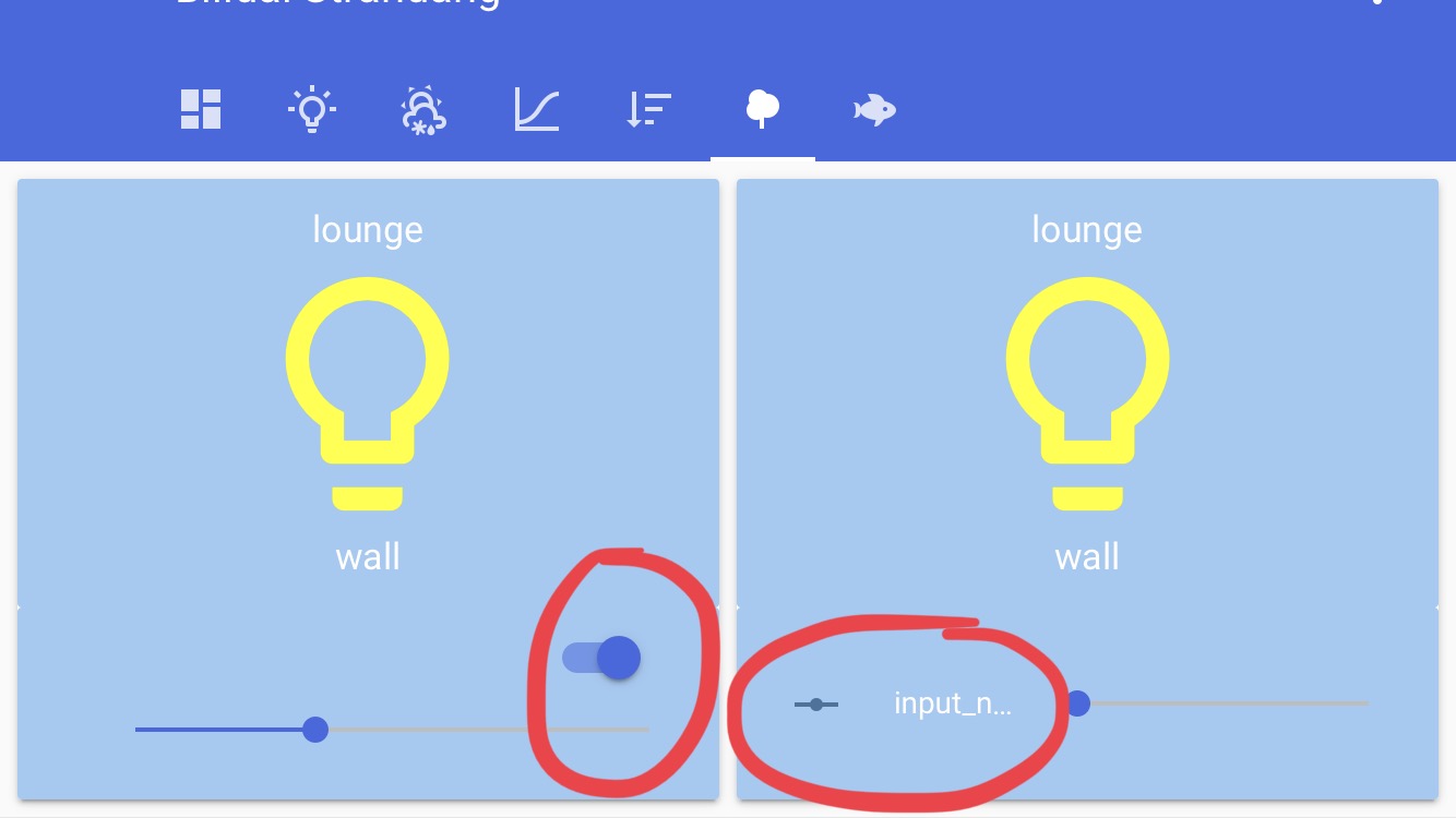

As experiments I have also tried light-entity-card but could not get rid off the switch and input_number.slider but could nit get rid off the icon and make the slider full width. Maybe there are ways to solve those issues?

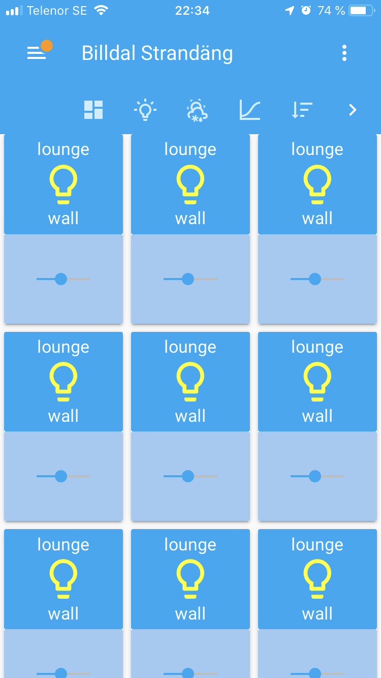

The latest version 3.0 of button-card allows you to insert a slider-entity-row (or any card) inside the button. I’m experimenting with it, it looks promising.
Wel the height looks better is what I saw. I did not try to change color yet, I’m hoping Jimz011 will come up with something to integrate it style wise into his pretty theme.
