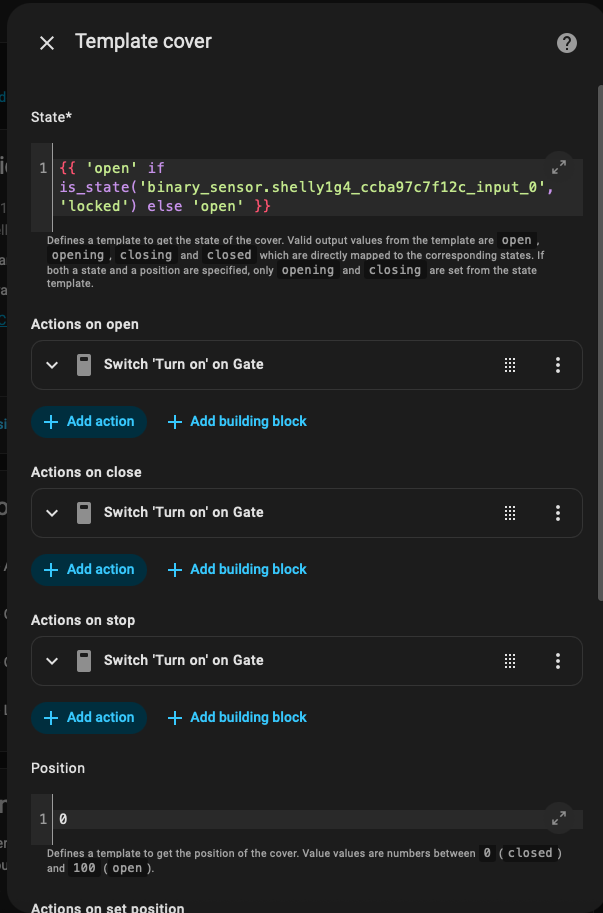

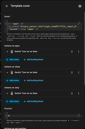

the template doesnt let me press the close button. but all the command are the same.
How ever i would like some diffrent status.
Here is what i got:
Your template has an if statement that results in either open or open.
In addition, a binary_sensor can never be unlocked it will only be on or off.
Test out your template in developer tools → template before using it in the sensor. That way you know it works. You can also look up the state of any entity in developer tools → states, where you’d see the state of your binary_sensor is off or on.
To get something functional without opening or closing states, you should be able to use something simple like {{ is_state('binary_sensor.shelly_blahblah', 'on') }}
Once you get something working, then you can work on adding the additional states.
