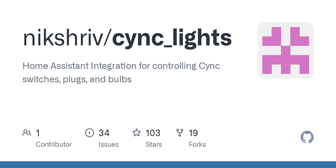

I have a Cync Bluetooth Light I would like to set up in Home Assistant but unfortunately the only integration that works with Cync lights is this one:
But I don’t have a wifi bulb or switch, so it doesn’t work with my bluetooth mesh bulb. I would really like to find a way to use cync2mqtt in Home Assistant but I can’t figure out how. Can someone make an add-on for it? Or is there another way? I’m running HA OS.
