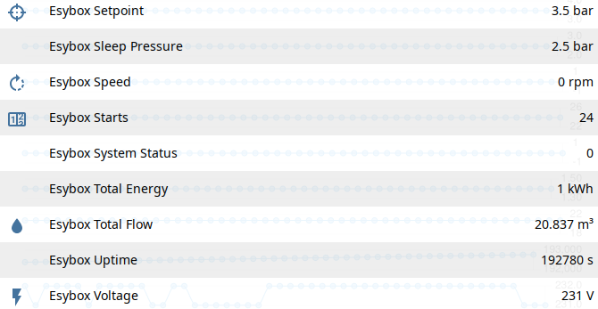

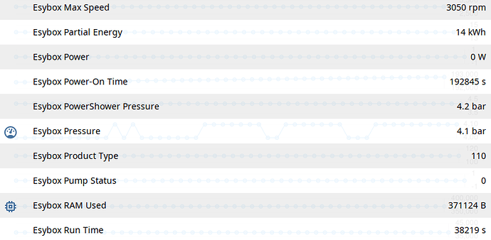

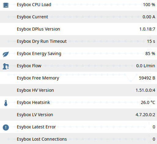

The integration is able to show any property that is available in the DConnect Website or App or in the DAB Live app.
See this image from the integration’s readme for an example (not all properties shown in image, more available when I scroll down):

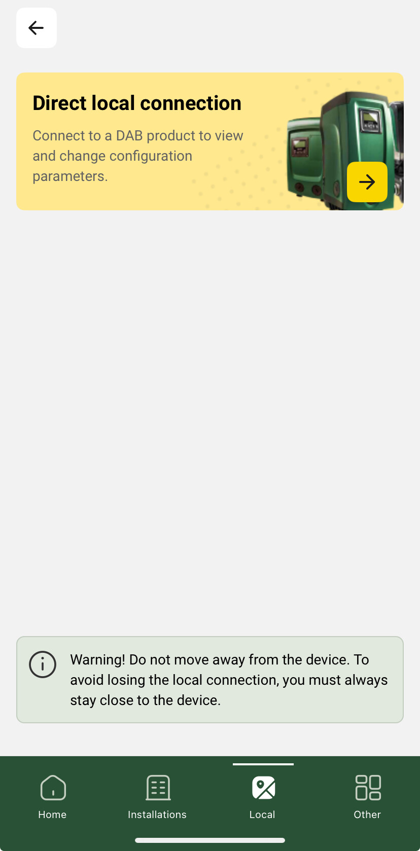

One thing I did see was that H2D has a “Local Connection” option when logging in. I wonder if this could be used by the HA integration to bypass going via the internet for reading/setting values?
@AstroBBoy
As far as I understand from DAB Pumps, the H2D app is intended to replace the DAB Live and DConnect apps. So those two will at some point dissapear. For a new user like you it is probably easiest to just use H2D.
Yes, there is support for a local connection in the H2D app (I suspect using Bluetooth). Previously DConnect had something similar but needed a physical button press on the pump device each time you wanted to reconnect. So that was not suitable for Home Assistant. Have not yet analyzed the communciation protocol used by the new H2D local connection, but it is on my todo list…
Thanks @ankoh I had another play with H2D after reading your message and I eventually found the settings I was looking for.
I also just walked out to my pump to check the Direct Local Connection option and yes, each time I want to connect I need to press a physical button to put it into a pairing mode.
Once in its great and I can access everything, but yeah the physical button will be the downfall unfortunately.

Getting there. Need to parse double nested JSON (because why not :slight_smile:) Some multipliers to tweak, need to automate serial number fetching (its used in all subsequent GET’s)
Then onto seeing how we POST stuff: data/time, setpoints, boost function etc.
There are more endpoints in the snoop logs, will look at that too - stuff that isn’t displayed in the app.
First connection still requires a button press on the pump to get it into ‘local’ mode and advertise. Once the connection is going it won’t drop unless nothing happens for about 20 minutes - then the pump reverts back to WiFi. Will try power cycling the pump through a smart plug to see if it starts advertising. Also don’t know how high some sequence counters will go, may need to re-connect every 24h or so to keep the counters down.
