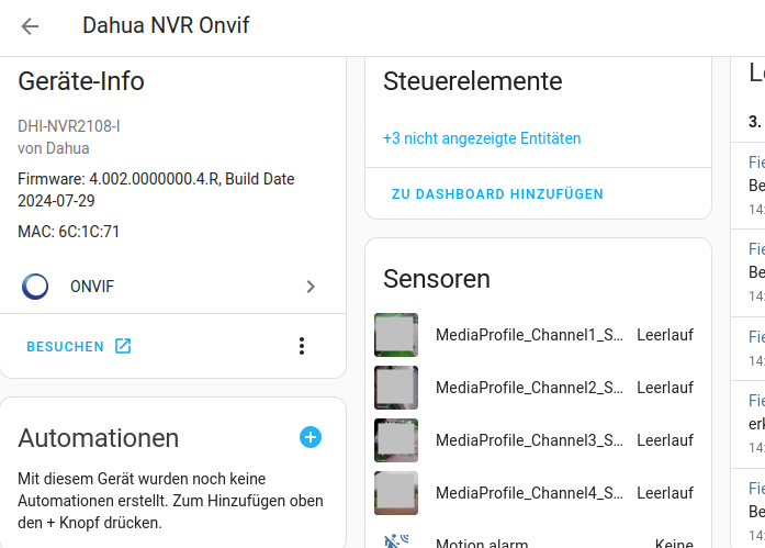

Which NVR Modell? Actually, this should also work with the Dahua integration from rroller. However, since this is no longer maintained and developed by rroller, I have been using the Onvif integration for all my Dahua cameras and my Dahua NVR2108-I for some time now instead of the Dahua integration.
Dahua NVR2108-I with 4 cameras and HA Onvif Integration:
Note: The sensor for IVS only appears as field detection once IVS has been triggered. This cannot be seen in the screenshot here.

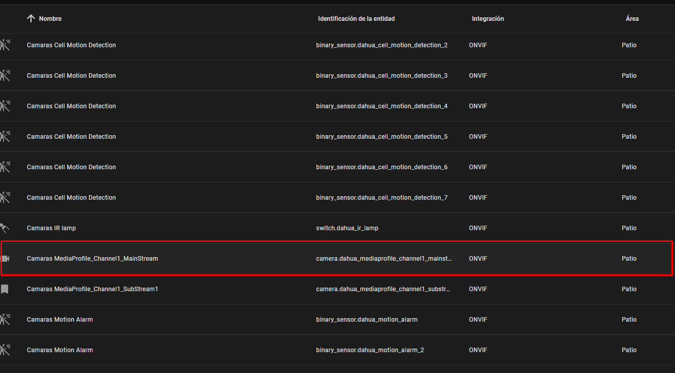

i got the same problem that OP.
Both on DAHUA and ONVIF integrations, can only see 1 camera. (got four)
Any help?

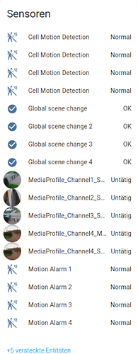

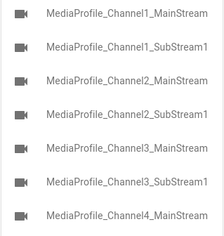

As per previous advice:
Still no problem. Using HA Onvif integration, my Dahua NVR continues to find all cameras (current 4) connected to the NVR and their three streams.
The streams I did not activate

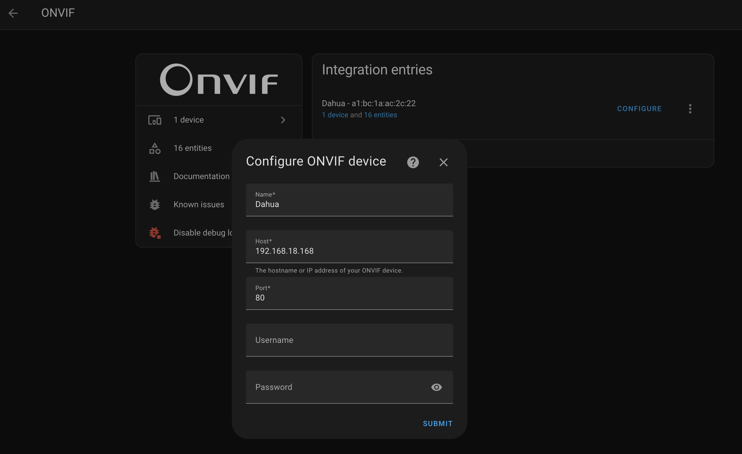

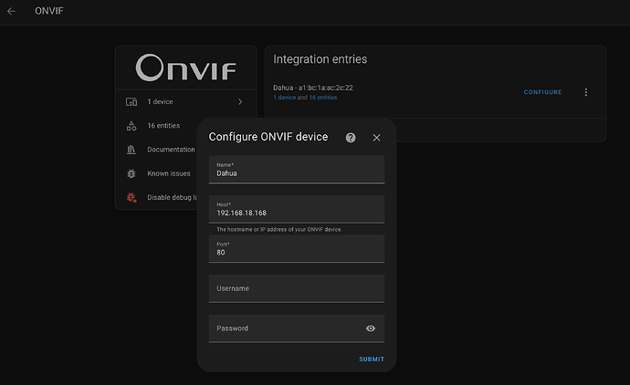

Somehow I’m not given the option to set a channel. Would it be a limitation of my device? Is there how to manually create this config?
Channel selection is only available with the Dahua integration of rroller. With the Onvif integration, the channels, and thus the streams, should be found automatically.
