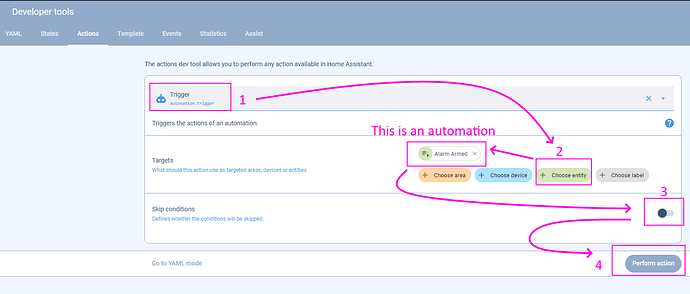

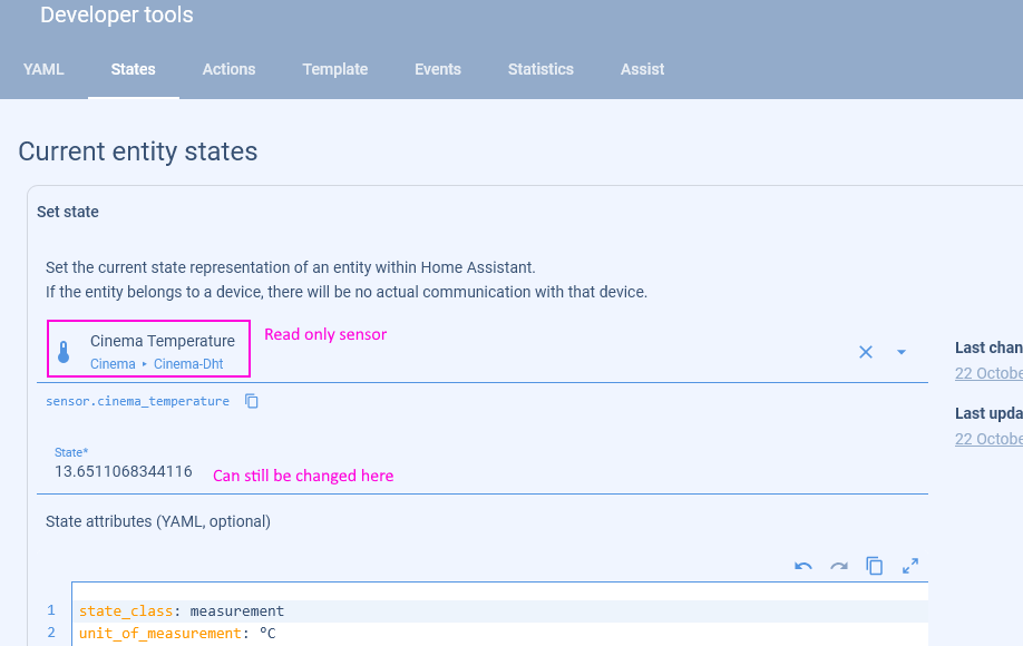

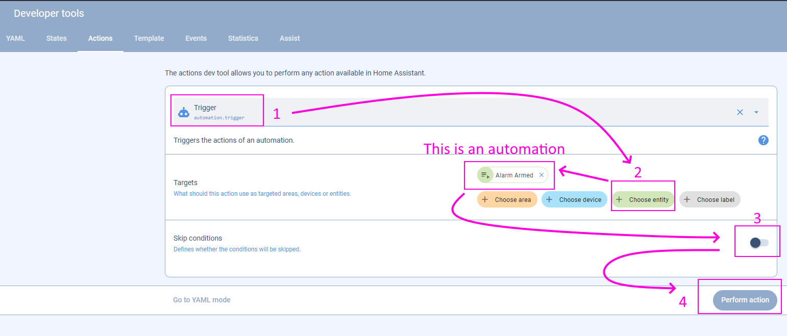

No you don’t. You have two options.
  1. Go to Developer Tools → States and change the value of your outside temperature sensor there to trigger your automation. The change is temporary and will be overwritten next time the sensor updates.
or
  1. Go to Developer Tools → Actions and run the trigger automation action with the the “Skip Conditions” toggle turned off.

  1. Yes it does work.
  1. See:
  1. I had tried to change the temperature value but since it is a read-only value, immediately after changing the value, it returned to the real value and I assume that this did not activate the automations.
