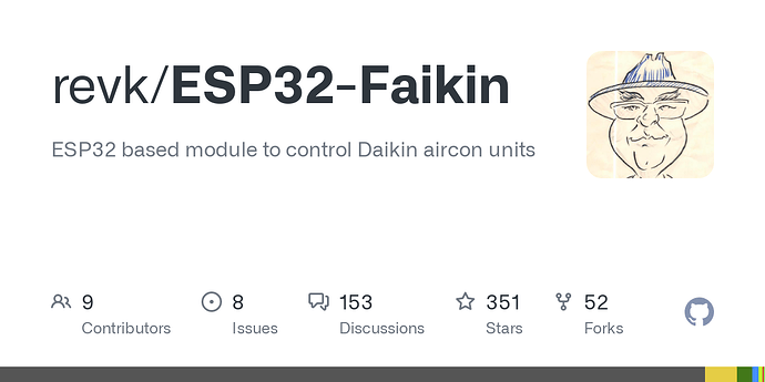

I have the faikin sollution I did it first with wire by wire connection but it stoped working i find the wright connector on ali express it fits not for 100% but it fits it is called the https://nl.aliexpress.com/item/1005006291181398.html?spm=a2g0o.order_list.order_list_main.23.ccaa79d2bxuR8O&gatewayAdapt=glo2nld
not expensive!
but also with the new connector i cant get the unit online? i aske the maker of the faikin on this how to trublle shut who can assit? it looks like the unit is not sending data to the the airco how can I diagnose this signal I double checked the wires can it be the case that cable is to long? now cable is 90 cm can that be the issue? an one an idea it shows the webpage and cant set parameters but not 0/1 wont go to 1
thx jd

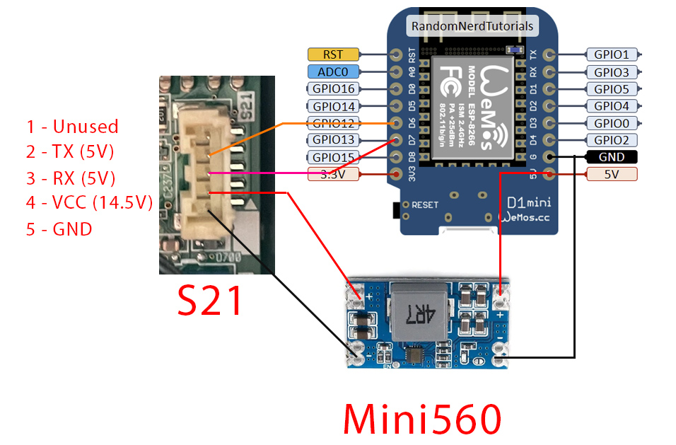

Thank you for sharing. This is what I understand about your schematic. Is it correct?"
