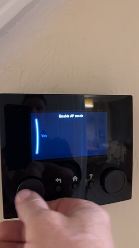

I manage to connect to Daikin AP wifi, but then Onecta app gives error - Failed to connect device.
When I connect to Daikin AP it shows no internet connection, shows in wifi setting that im connected but dont show wifi symbol on top of the phone , maybe because theres no internet connection.

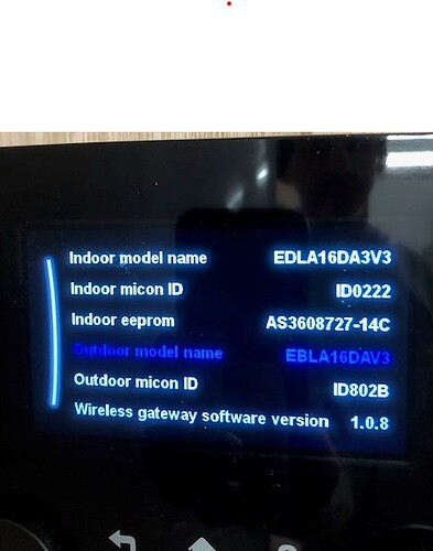

WLAN wifi module - BRP069A78
Daikin - EBLA16DDAV3/EDLA16DA3V3
Onecta app version 3.21.2
My iOS - 16, but also tried on Android phone (does exactly the same thing)
Wireless gateway software version 1.0.8

It was on the Daikin Heat Pump control panel somewhere. Possibly the “Information” screen I think? There was a load of version numbers…
